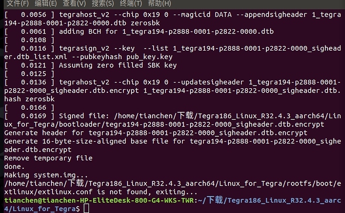

I have some problems in the Jetson_AGX_Xavier_PCIe_Endpoint_Software_for_L4T .
Firstly, I used Jetpack4.4 to Installing the development environment.
Then when I do the step as follows,
sudo ./flash.sh jetson-xavier mmcblk0p1
It has some problems.
when we use L4T 32.1,it remainds us that it flsahes sucessful,but the xavier system can’t open and start;
when we use L4T 32.1,it remainds us that it can’t find the file.
so how can I to slove these problems?

  1. I remember rel-32.1 does not support pcie endpoint at all. You should at least use rel-32.3.1
  2. This error means your setup on host is not completed so the rootfs has something missing. Please follow the quick start guide.
YES,I have solved this problem, In the guide of l4t quick start.I do something before I do the flash . such as follows:
when I do the 'sudo tar xpf ’ .I finished the flash and the xavier sysytem worked.
