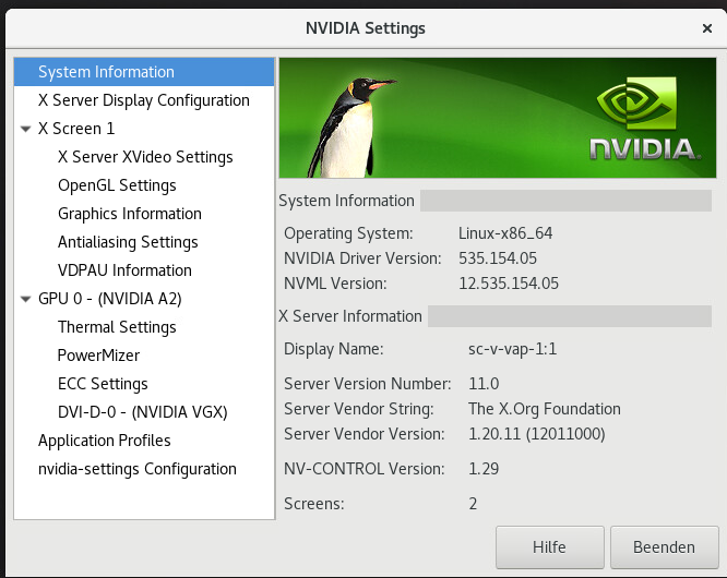

I have a Red Hat 8.9 VM that has a virtual graphic card and a Nvidia GPU, passtrough by the ESXi server.
My goal would be, that as a first step, I can open the VM with my VMware Workstation and the GUI is powered by the Nvidia GPU. E.g., when I start the nvidia-settings I see the X tab and can configure displays.
After a lot of experimentation, I think I am close.
Maybe somebody can give me a hint, if I have somewhere a misconception.

Experiment 2: Result of nvidia-xconfig => Total strange behaviour
I created with nvidia-xconfig a xorg.conf file.
Result:
(same as in experiment 1)
OK: I can login.
OK: nvidia-smi outputs that xorg is started
NOT OK:
I would expect the Nvidia GPU to be used for “Grafik”. Not llvmipipe.
(new behaviour)
OK: nvidia-settings shows me the X-Window part
NOT OK:
The mouse is acting completely strange. When I click, then there is a big offset.
Like… I click in the left upper corner, and the context menu is shown.
If I move the cursor into the second half of the monitor, the cursor is vanishing.
