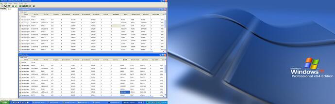

iTimeChunk == 4 and iCurrentTraceChunkSize == 80
Why does it take so much time? bank conflicts? if so what can be done?
Thanks in advance
