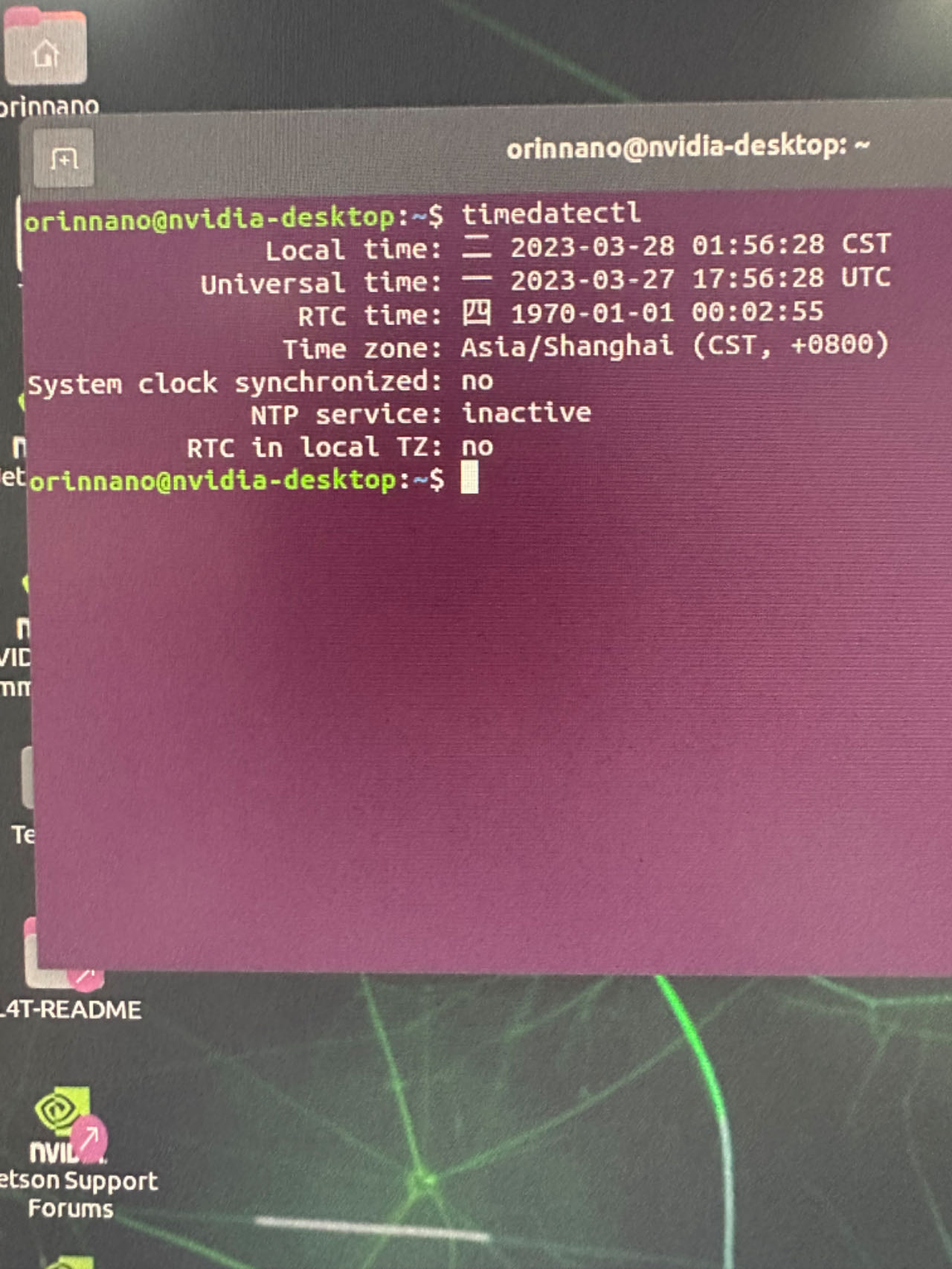

I attached a battery to my custom board to enable the PMIC RTC function.
The battery is working normally.
After I closed the ‘Automatic Date & Time’, and try to set the RTC time, no matter how I set the RTC time, it fails after device reboot.
For example, I use the following command to set RTC time
From the above it seems to work, but after I reboot the device, the RTC time changed back to 1970
Please give me some suggestions to make PMIC RTC effective, thanks

Please first verify whether your device is using rtc0 as the RTC source.
I think the default one is rtc1, which is integrated into the Tegra Soc itself, and does not have connection to the external battery.
Yes!rtc is pointing to rtc1.
You mean the external battery is connected to rtc0 and the rtc0 is not being used as the RTC source?
Well, how do I set the rtc0 as the RTC source?
YES. Exactly.
You can do it by either changing the udev rule, or by re-building the kernel with customized kernel config.
