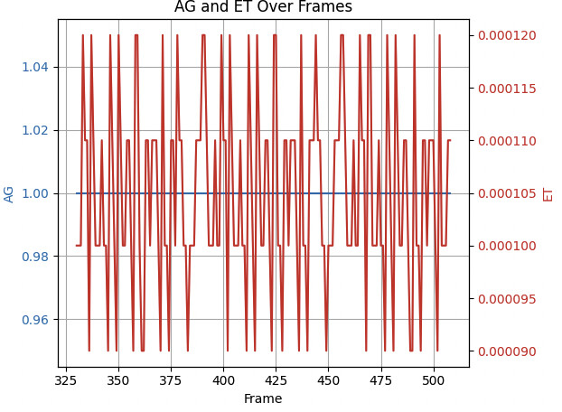

sorry it take a while, here is the log of the data. starting from cc330, you can see the exposure jumps around when it’s close to the minimum exposure time of the sensor. the row time of the sensor is about 30um.
Thanks,
Samuel

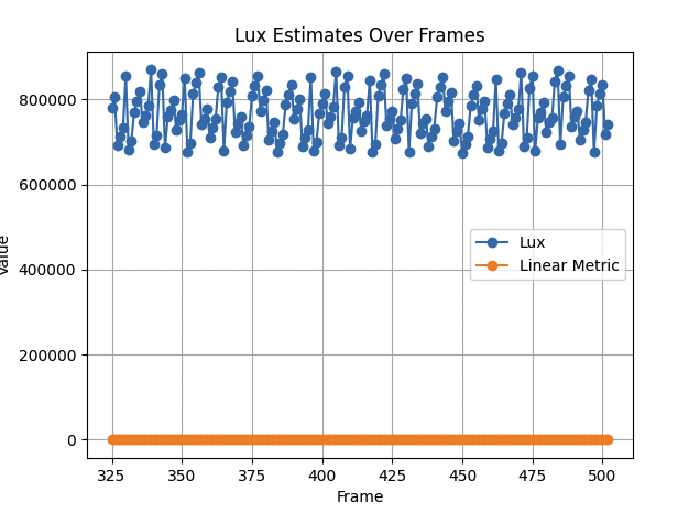

I’m also attaching the video and plot of Exposure fluctuation. it is similar to when the sun is inside field of view. the luxEstimates also fluctuates.

hello samuel.shen,
there’s convergenceStatus to indicate the specific algorithm state.
for instance,
convergenceStatus: 1 to indicate searching, algorithm is still searching for an optimal set of values.
convergenceStatus: 2 to indicate the specific algorithm is in a converged state.
convergenceStatus: 4 to indicate the 3A algorithm has failed to converge because the image is overexposed.

the sensor exposure and gain are close to the min exposure but not quite yet. as I mentioned the camera row time is 29.77us so the step size is 29.77us, and 59.54us(value=2) as min exposure time. it feels like the auto exposure is trying to set a value in between the step size and it is fluctuating. is there some parameter I could config to let ae know there is certain limitation?
for example, Here is two sample video, with one exposure set at min value, 60us and it is not flickering.
another one trying to set exposure between 120us and 90us, ae is keep hunting. similar behavior if I move the camera when the ae jump between 263.5us and 234.2us.
another question? if the sensor has step size limitation, will the ae be able to use gain to smooth the transition?
