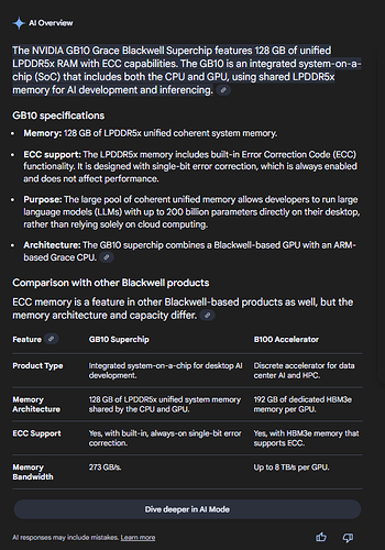

Also, I assume LPDDR5x, unified system memory is ECC? It’s not mentioned explicitly in the specs, but I assume since it’s LPDDR5x it should be ECC?
Memory: 128GB of coherent, unified LPDDR5X Low-Power Memory
Will not have ECC.
Connect-X (200G x 2 QSFP). We support stacking of up to 2 DGX Spark with an approved QSFP cable at this time.
If that’s the case, there’s marketing content from NVIDIA or NVIDIA Partners that infers that the DGX Spark GB10 Superchip provides ECC support. If they do not this makes these units a serious risk for model training.

It’s worth noting that while the DGX Spark doesn’t come equipped with an ECC-enabled chip, the LPDDR5X operates with ‘some’ error detecting ECC capabilities e.g. on-die ECC that corrects errors within the memory chip itself. Still this capability doesn’t remove the risk, but I’m placing it at moderate to high vs. extreme risk after further research.
Also, all the other tradeoffs doesn’t make the lack of a proper ECC a dealbreaker, at least for me.
