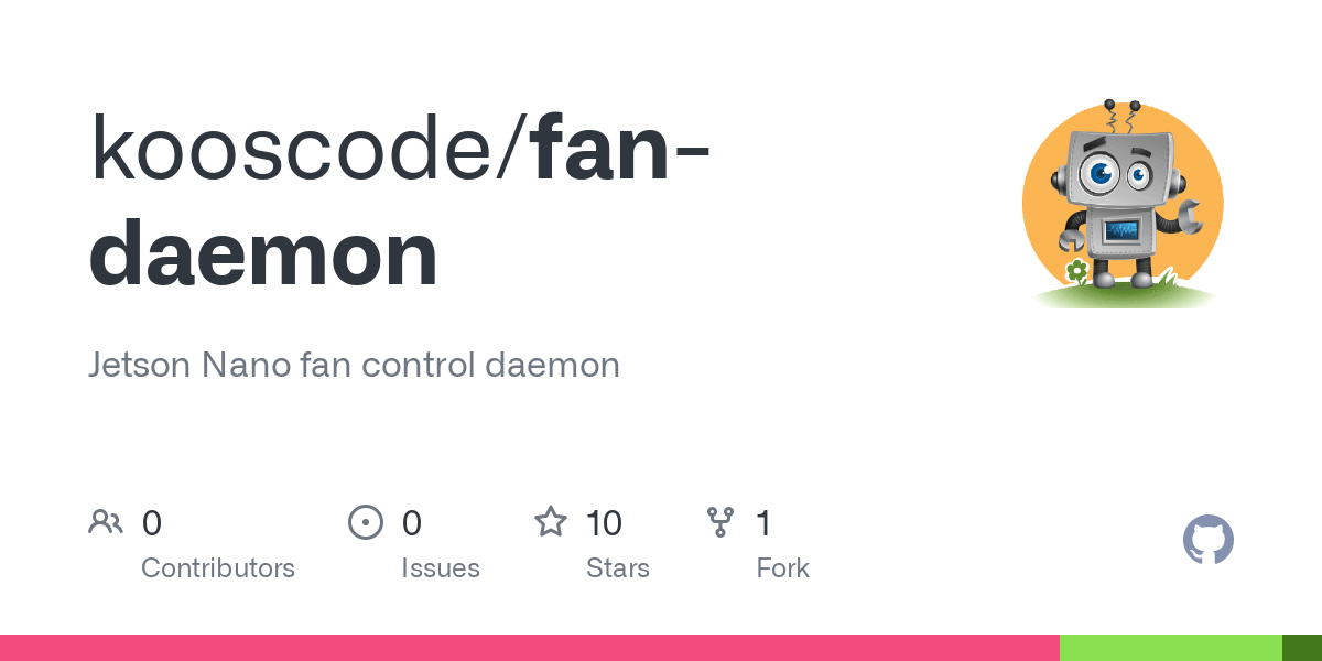

Hey @hooperbill
I love you C++ daemon!! Very nicely done! I forked it and modified it a bit for my use.
For some reason my jetson_clocks would not run properly and needed a bit of a delay.
So i added that feature and also minimized it a bit and removed the code:blocks stuff and generated make file, etc.
have a gander… be happy to generate a pull request if you’d like.
Koos
