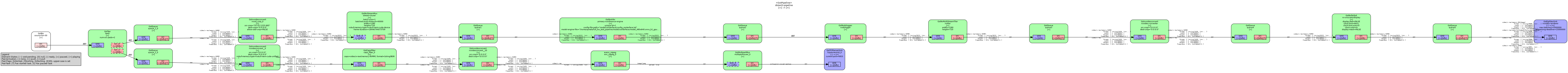

Which elements of DeepStream have you used in your pipeline? Can you show us the whole pipeline?
I have recreated my Pipeline with the deepstream-test3 app. Below is my pipeline graph.
I’m using C++ APIs.
I have a probe function at sink pad of caps filter of the non-streammux branch of the pipeline, wherein I use the Image in following way.
