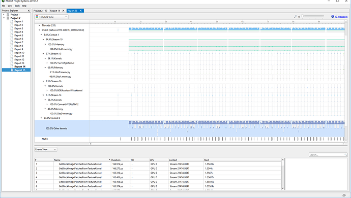

I am trying to use streams on cuda 10.1 to parallelize blocks of 16x16 threads in a grid of 4x1
I call createStream on the elements of an array of cudaStream_t and get a separate value for each.
The code runs slow but the NSight Systems 2019.5.1 is a bit vauge.
For some reason there are 2 contexts and it looks like the single variable streams exist and the ones in the array are all given the same number. I will try and type the text, there is no cut-n-paste…the v and > are the tree arrows

   v 98.6% Context 2   with tooltip "Combined view with less than 1% impact"
     100.0% other kernels
This second context is the work that needs to be parallelized accros streams
Each kernel launch of <<< [4,1],[16,16],0, stream>>> has a unique id on the call.
But in this view they all show the same stream ID???
In the events view there is a column called Context with “Stream 2147483647” on every kernel and they are shown run completely one after the other stretching the work out.
Now obviously 2147483647 is -1 on signed MAXINT :-(
I have spent many, many hours and tried the defines and flags for different stream default thread stuff and none seems to work.
If it wasn’t running so damn slow, I might think the tool is just collapsing the stream view and hiding all the stream id’s into a -1.
Also the stream is a memcpy and a launch and instead of 1 of each on each stream, I see all the memcpy colected into stream 10 and all the GetBlockImagePatchesFromTextureKernel on the -1 stream in “Context 2”

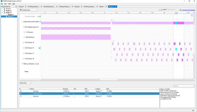

The difference here is the stream Ids are correct and it shows the stair-step like pattern.
The left of the screen is the default stream and the right side is the streamed version.
The reason this is not an improvement is that it is copy(30ms) dominate, the kernels run too fast(215us) on this hardware for the overlap to outweigh the launch overhead?
Example not appropriate for this Hardware but it shows me that it is possible on windows and if I compare the projects, maybe I will find the thorn.

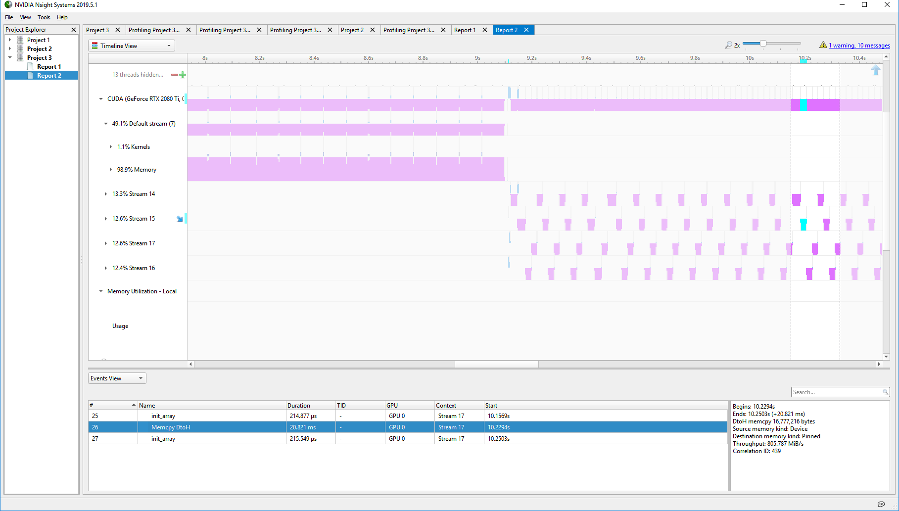

Here is a picture from Nsight systems similar to yours:
External Media
I didn’t spot any obvious significant differences.
Right. kinda an anti-sample in that is showing that streams do not help at all if the kernel is fast and you are a significantly memcpy bound process. Since you cannot overlap the memcpy’s
certainly doesn’t look like the final one here.
lloks like “Host Limiting Performance” example

In reviewing the common pitfalls, I think I see some areas of concern to address.
I think the source of the 2nd context is the mixing of driverAPI with runtimeAPI becasue I need to use nvdec and ALL examples use driverAPI.
Is there an example of how to use NvDEC with runtime API?
For anyone that ends up here, the issue with no stream parallelism was caused by the 2nd context visible in the nsight screenshot. That -1 stream ID and 2nd context are the clues.
I used the NvDecoder deviceAPI example to decode a frame for analysis and when it passes the frame to the code that does the runtime api kernel launch the runtime api lazily creates the Primary ctx. This resets and wipes out some important things but then I have 2 contexts.
with the memcpy and kernel launch in the same stream, All the memcpy’s run in the device context and all the kernel with a stream id as -1 are clumped together in the 2nd Primary Context.
It is a combination of the hiding of the context and the lazy creation in the runtime api together with the new NSIGHT tool redesigned interface that got me.
THE SOLUTION:
Put a cudaSetDevice(0) in the class using the runtime api to have them use the same context.
When you only have one device and are working of the samples it is a surprise to have this kind of fail by default.
Is there anyway to get the NSight System tool to put the items in a stream in order instead of separating into memory and kernel? and/or turn off the multiple summaries? the line which creates a redundent copy is also separated. (my display is 16:9 not 9:160)
