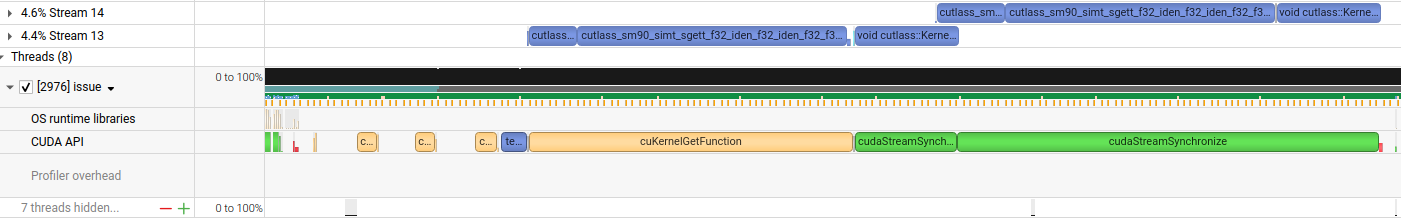

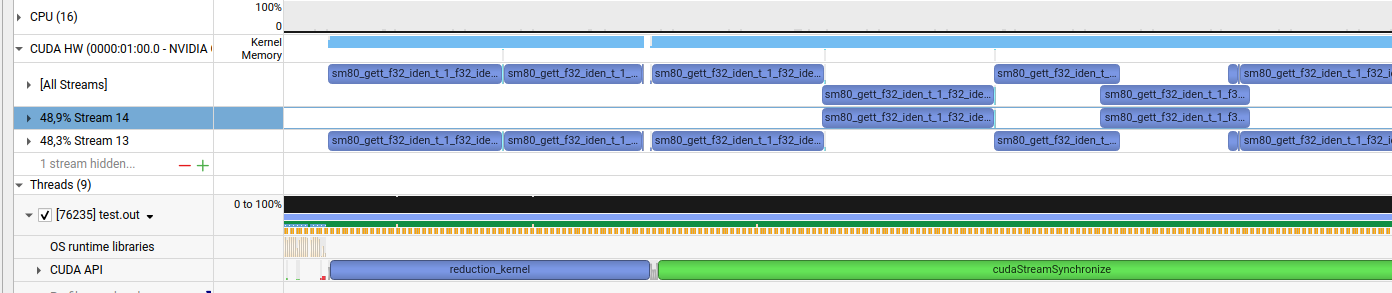

Concurrent contractions/qr in cutensornet
I am currently implementing an algorithm were I am using cuTensorNet to contract and qr decompose some tensors. I have implemented the contraction in a way, that the contraction plans, allocation and everything else is done separately beforehand and then I basically only call cutensornetContractSlices on two different tensors with two different streams. However I have noticed while profiling, that the kernels for the contraction are still called sequentially. Here is a example, this is basically the cutensornet_example just with everything twice:

   cudaStream_t stream;
   cudaStreamCreateWithFlags(&stream, cudaStreamNonBlocking);
   cudaStream_t stream2;
   cudaStreamCreateWithFlags(&stream2, cudaStreamNonBlocking);
   // cudaStreamCreate(&stream2);
   cutensornetHandle_t handle;
   HANDLE_ERROR( cutensornetCreate(&handle) );
      cutensornetHandle_t handle2;
   HANDLE_ERROR( cutensornetCreate(&handle2) );

When profiling I see this:
I assume the sm80_gett… Kernels are the internal Kernels used to contract the tensors.
Why are the Kernels on stream 13 and stream 14 not executed in parallel? I noticed the same thing when doing 2 qr decompositions on two different streams. Is this just the way it is in cuTensorNet or am I missing something?
Thank you for contacting us and posting your question.
Some basic knowledge about streaming workload.
For any independent operations happening in different streams, we can identify 2 or 3 situations:
  1. if the operation on stream_1 fill the GPU SMs with load, then the GPU runtime scheduler is going to fill all the SMs with work. Thus stream_2 will be queued after stream_1, thus making it look like sequential ( maybe tiny overlap will happen at the end of stream_1 execution).
  2. if the operation of stream_1 is small such as it doesn’t fill the GPU SMs with work, then the runtime would be able to put operation from stream_2 into the SMs and users will eventually see it in the profiler
  3. if the operation of stream_1 is very very tiny (let say micro seconds) then the scheduler will not have time to dispatch stream_2 before stream_1 finish and user most likely will not see any overlap.
For the example shown here, you are running in regime (1)., you might see some overlap at the end of stream_1.
I rerun your example and set extents to 18, I was able to see some overlap at the end of stream_13. similarly I changed extent of l=4096 and a=2 and k=128, now you can see more overlap at the end of stream_13.
I hope this clarify.
