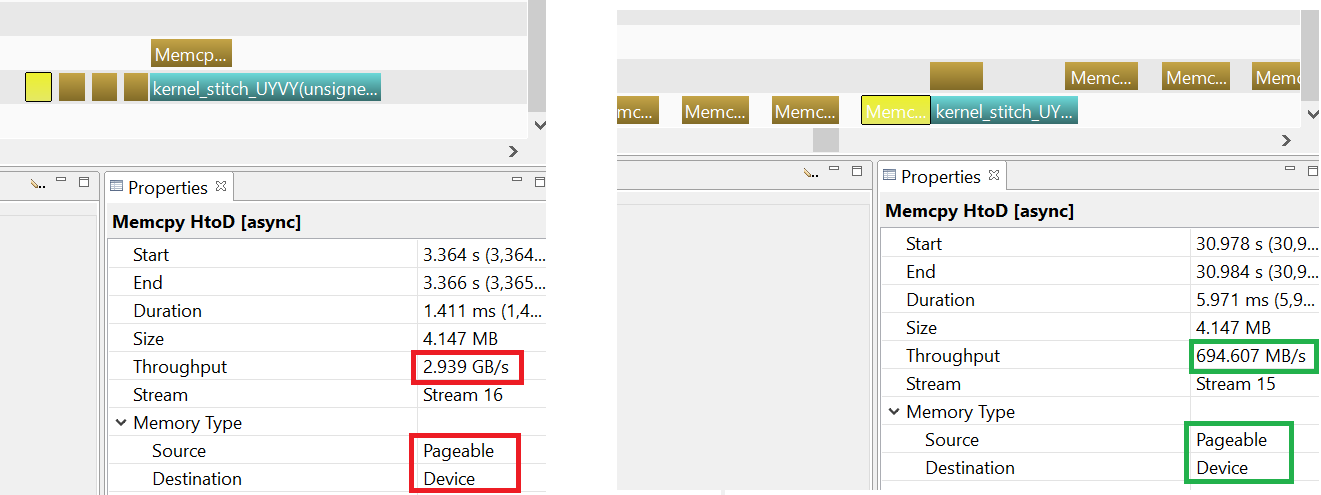

However, there’s something I can’t find the answer from these doc. We have 2 demo systems running the same application. Both systems use TX2, while one uses Magewell Pro-Capture card, and the other uses TC358743. The buffers used in capture (before feeded to cuda) are both pagable. They showed different throughput when memcpy H2D.
External Media
In the picture, left side is from the system with Magewell card, right side is from the one with TC358743.
I wonder if there’s more properties than Pagable/Unpagable that eluded me, that is making the throughput difference. What is that?
Suppose that Magewell is a 4K capture card while TC358743 only supports 1080p.
Could you confirm this with the spec of your capture card?
If yes, the bandwidth of Magewell should be four times larger than the TC358743.
The capture card is Pro Capture Quad HDMI:
http://www.magewell.com/pro-capture-quad-hdmi
From the website, each port can capture resolution up to 2048x2160, and it has 4 ports.
Our system with TC358743, has 6 TC358743 connected to CSI-2 ports of TX2, each one uses 2 lanes.
I think both systems are capable of capturing 1080P30 videos. This can be confirmed by running a gstreamer pipeline below, and see if it’s 30fps (It is, for both systems).

The bottleneck appears only when I add the cuda accelerated component, which use cudaMemcpyAsync to do the H2D copying.

For both systems, I ran jetson_clocks.sh to fixate the max performance before running the pipeline. You can see the H2D throughput difference is still there in the nvprof files.
Also, I tested tegra_multimedia_api/samples/v4l2cuda on both systems, with MMAP as io mode, and the throughput difference again exists (this time 800MB/s vs 3GB/s).
