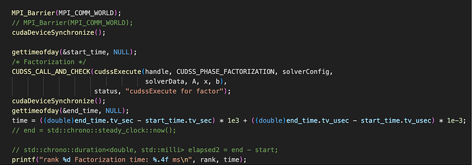

I’ve been benchmarking the cudss_mgmn_distributed_matrix example from cuDSS on several GPUs — RTX 4060, RTX 4090, and NVIDIA A100 — using OpenMPI with mpirun -np 1 to run a single process on each GPU.
Setup:
  • Modified the example to load double-precision matrices from .mtx files.
  • Added timing code using both gettimeofday() and std::chrono::steady_clock::now() to get reliable execution times before and after cudssExecute.
  • Since cuDSS does not expose internal FLOP counters or nonzero statistics, I used SuperLU_DIST’s flop count to estimate GFLOPs for comparison.
Observation:
  • On RTX 4060 and 4090, several test matrices report GFLOPs that are more than 2× higher than the theoretical peak FP64 performance of the GPU.
  • On A100, the performance is roughly 10% of the peak, which seems more reasonable.
  • All results have relative numerical error < 1e-10.

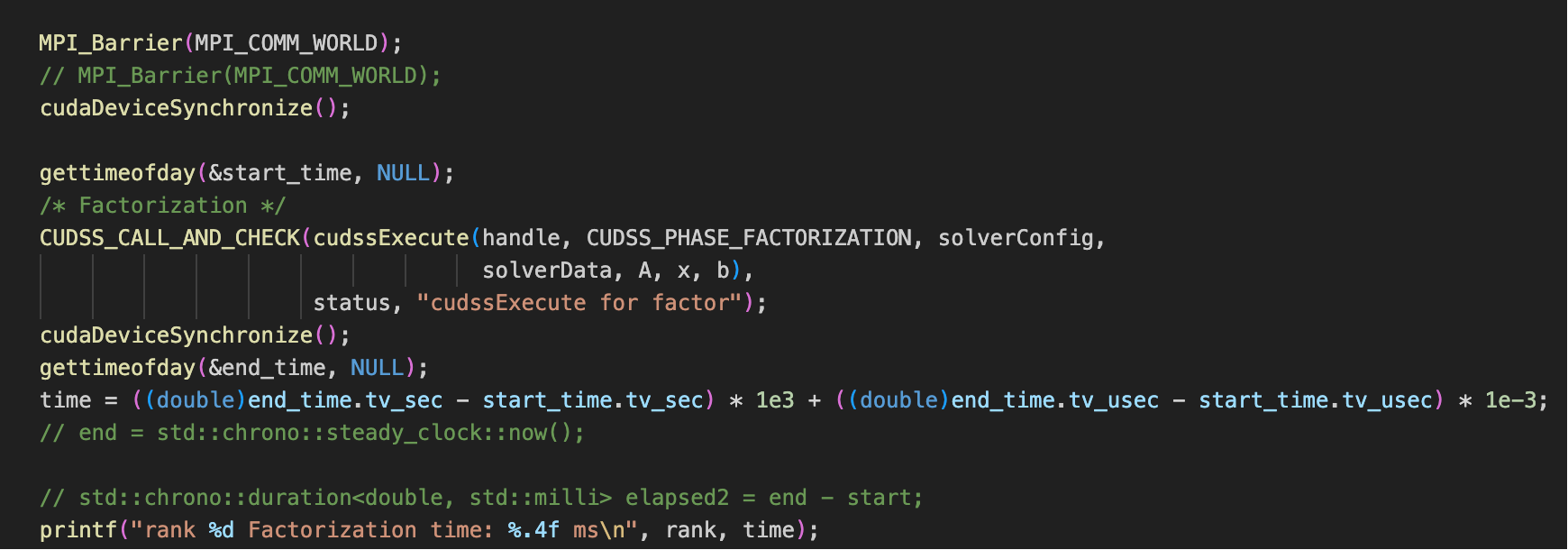

  • The timing code used for measurement is shown below:
Questions:
  • Could this be due to a misestimation of FLOP count (from SuperLU_DIST) not matching cuDSS’s actual workload?
  • Is cuDSS performing some optimized computation (e.g., reduced flops, mixed precision) that causes the GFLOPs calculation to be misleading?
  • Has anyone observed inflated performance metrics like this when using cuDSS or similar sparse solvers on consumer GPUs (Lovelace, Ada)?
  • Is there a better way to estimate actual FLOPs or execution efficiency for cuDSS?
Any insights would be appreciated!

I’m currently using cuDSS with the timing methods described above. I’ve noticed that, compared to other sparse direct solvers like MUMPS and SuperLU_DIST, cuDSS shows significantly better performance in the numerical factorization phase.
However, I’m not entirely confident whether my timing or usage of cuDSS is entirely correct, so I tried to evaluate performance from another perspective — by estimating GFLOPs.
Since cuDSS does not expose the number of nonzeros after symbolic factorization or internal matrix structures, I couldn’t calculate the actual number of FLOPs performed by cuDSS. Instead, I used SuperLU_DIST’s FLOP count as a rough approximation.
The resulting GFLOPs, however, exceeded the theoretical peak performance of the GPU, which made me question whether I was measuring time incorrectly. But given how simple the timing code is, there doesn’t seem to be much room for a mistake there.
Right. The often repeated mistake is missing synchronization (because by default, cuDSS factorization and solve are asynchronous, which also would be true for MGMN with a single process) but your code snippet has it.
