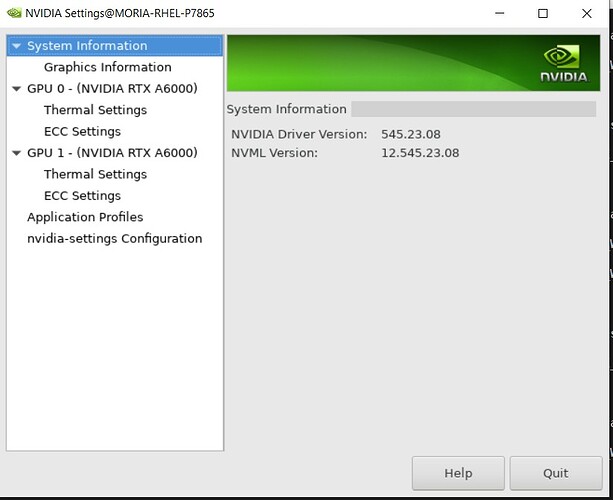

one thing to check is whether SLI is enabled. I don’t know if you are running a graphical desktop, if so you can check via nvidia-settings (i.e. the NVIDIA linux graphics control panel) here is a recent, possibly similar report, albeit on windows
Thanks for your comment.
I won’t be back in the office until Monday but we have MobaXterm which is able to show most GUIs and everything from the terminal. I’m not sure exactly if there is a graphical desktop or not so I will have to check in with that on Monday.
However, using MobaXterm I was able to run the nvidia-settings command from the terminal and a window popped up.
Unfortunately, after searching through it I could not find anything labeled or related to SLI.
Would you happen to know where this setting is located so I can check if this fixes things?
Edit: this is the window that pops up on my screen for reference:

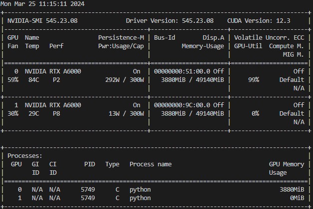

I have the nvidia-smi results as well:
Here we can see that both GPUs are still allocating the same amount of memory, even with SLI disabled. I think I mentioned this before but we can also see that only GPU 0 is actually being used for computation as noted by its power consumption. It’s very puzzling that GPU 1 has the same amount of memory allocated while not being used for any computation
Your python code is “using” GPU 1, meaning the process has touched it.

The default datatype for np.ones is float64, i.e. 8 bytes per element. You are requesting 1 billion elements, so 8 billion bytes should be needed. A memory allocation of 3880 MiB is not consistent with that. And there is nothing in that numba code that could possibly “spread” that allocation across 2 gpus. (nor does 2 allocations of 3880MiB account for it, either).
Sorry, the screenshot I just posted was not from that code, I was running some PyTorch stuff in the background and just used that instead because the issue is still present
Here is the nvidia-smi output from the code I posted:

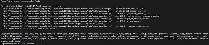

So there is a library called faulthandler in python which tries to help diagnose seg faults.
I ran it with my code and got this output:
I’m not sure if this helps but I just figured I would post it.
