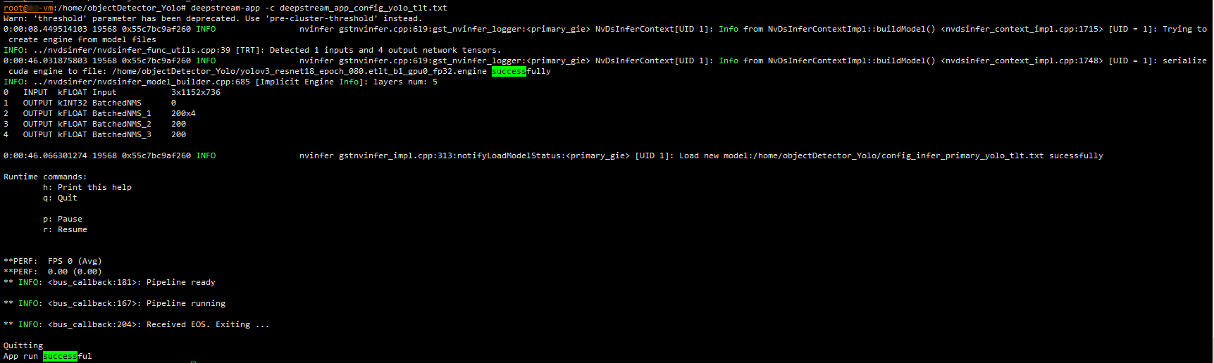

Deploy the Yolov3 model trained on TLT, but the target cannot be detected
I trained the Yolov3 model on TLT, the mAP is 88.9%, and verified that the deployed model can accurately detect the target.
But using the Yolov3 example in DeepStream to deploy the trained etlt model, it runs without problems, but the target cannot be detected. Why is this happening? how should I solve this?
Thank you very much

Did you change any config in the training?
If you did, you need to make the correspding change to the DS inference config file, i.e. deepstream_app_config_yolo_tlt.txt.
