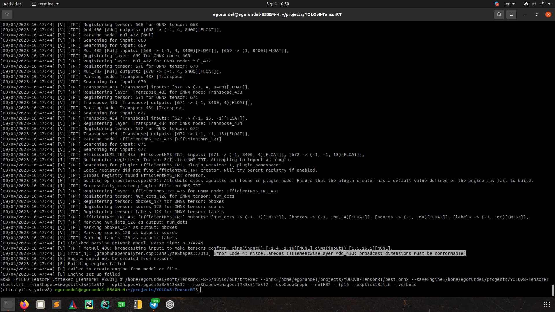

Hello, respected guys! Can you help solve my problem when converting a model with dynamic dimensions from ONNX to TensorRT Engine (.trt)?
I run this command:
/home/egorundel/soft/TensorRT-8-6/build/out/trtexec --onnx=/home/egorundel/projects/YOLOv8-TensorRT/best.onnx --saveEngine=/home/egorundel/projects/YOLOv8-TensorRT/best.trt --minShapes=images:1x3x512x512 --optShapes=images:6x3x512x512 --maxShapes=images:12x3x512x512 --useCudaGraph --notf32 --fp16
After which I get an error:
Error Code 4: Miscellaneous (IElementWiseLayer Add_430: broadcast dimensions must be conformable)

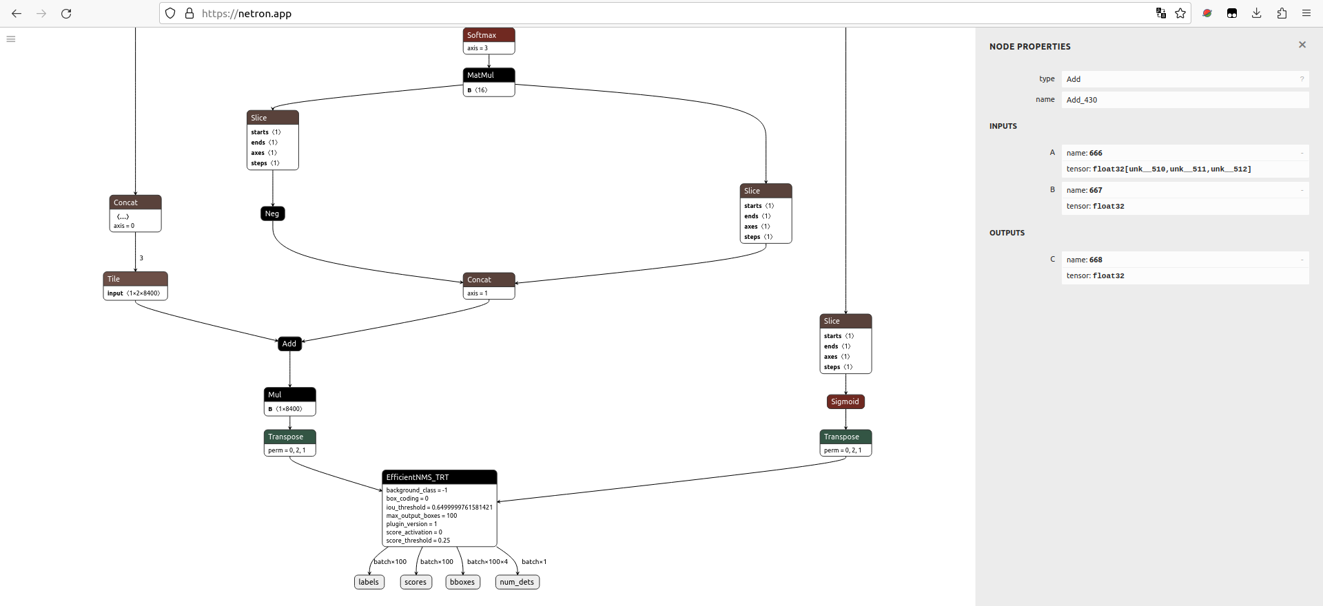

In netron.app, the model looks like this:

@spolisetty Hello! I haven’t parameter keepdims in Add node.
I did this ONNX model with dynamic shapes and batch by this code:
https://github.com/triple-Mu/YOLOv8-TensorRT/blob/triplemu/dynamic/experiment/det_dynamic.py

Looking at the logs of the trtexec command used, a 512x512 input image shape is being set. If we understand the graph correctly, a 512x512 image results in 64*64 + 32*32 + 16*16 = 4096 + 1024 + 256 = 5376 anchors. However, the Tile_428 op (just before that problematic Add_430 op) has a hardcoded 8400 anchors on it. So the Add op is running with two input tensors, one with an anchor dim of 8400 and the other with an anchor dim of 5376, thus the error.
So there are two possible solutions:
  1. Use the exact image size that this model was exported for, such that it ends up using exactly 8400 anchors.
  2. If the 512x512 input image is a hard requirement, then the anchor generator will need to be updated to use that input resolution.
