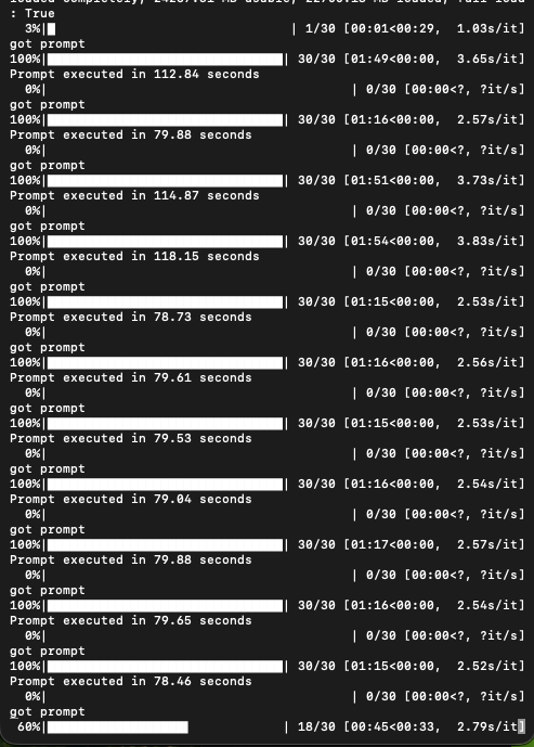

Thank you @provos . I really appreciate your work. Can you please tell what is your efficiency during inference? How long does it take to generate 1 image? Thank you!
around 80 sec per image ! happy now ! (with 30 steps)
