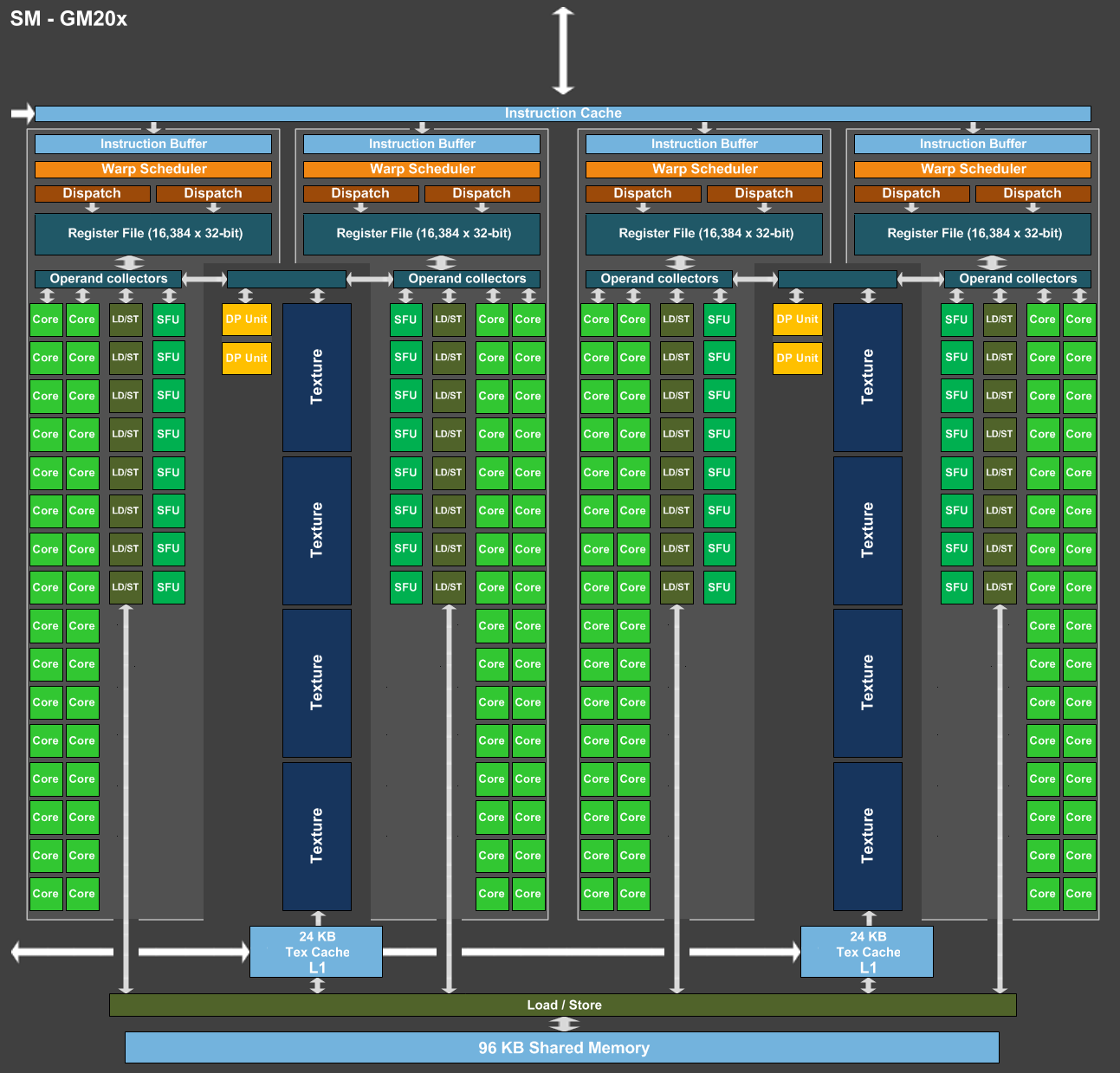

From my reading, especially of the appendices in CUDA C programming guide, and adding some assumptions that seem plausible but which I could not find verifications of, I have come to the following understanding of GPU architecture and warp scheduling.
I would really appreciate it if someone with more expertise could read this and comment on any misunderstandings they see:
GTX 960
CUDA capability 5.2
8 multiprocessors, 128 cores/multiproc, 4 warp schedulers per multiproc
Max 2048 threads per multiproc
Max 1024 threads per block
GPU max clock rate: 1.29GHz
Blocks are assigned to a multiproc
Thus, with 1024 threads per block, 2 blocks can be live (“in flight”) on a multiproc. More if you have less threads per block.
When a block is assigned to a multiproc, the warps of the block are distributed statically among the 4 warp schedulers.
With max 2048 threads per multiproc, i.e. 64 warps, each scheduler gets at most 16 warps (possibly from different blocks).
Each scheduler issues 1 instruction from one warp per cycle, if it has a warp ready to execute. So if the current warp is not ready (e.g. waiting on a memory transaction or an FP function unit), the scheduler switches to an alternative warp assigned to this scheduler that is ready without costing any delay if such a warp exists.
The advantage of each scheduler having upto 16 warps to schedule means that you can cover quite a bit of latency while waiting for a delayed instruction to complete (mem, function unit etc.) by switching between the other 15 warps.
If a scheduler does not have warp ready to execute, it can not “steal” a ready warp from another scheduler.
Thus in the theoretical optimal case, if you have a kernel with 32*N threads in total, and the kernel is K instructions long, you could potentially execute the kernel in N * K / (8 * 4) cycles at maximum 1.29 GHz (8 multiprocessors, 4 warp schedulers)

you seem to have a theme running through related to static assignment of warps to schedulers, including statements like a max of 16 and “cannot steal”
I don’t know where any of that is documented. (Please point it out if it is documented somewhere, I may have missed it.) AFAIK the warp schedulers draw from a pool of available/ready warps, and select one or more instruction, per cycle, from each warp, per scheduler.
Also, you indicated 1 instruction from 1 warp per cycle, but most warp schedulers are dual-issue capable, as long as they can find 2 independent instructions from the same warp/instruction stream, in a given cycle.
txbob, for you it may be easier to ask inside nvidia
it’s not clearly documented. in Fermi whitepapers, register file (page 8) was pictured as monolith, but page 10 shown that left scheduler executes only even warps, while right scheduler executes only odd warps: http://www.nvidia.com/content/PDF/fermi_white_papers/NVIDIA_Fermi_Compute_Architecture_Whitepaper.pdf
Kepler whitepaper also pictured register file as monolith: http://www.geforce.com/Active/en_US/en_US/pdf/GeForce-GTX-680-Whitepaper-FINAL.pdf

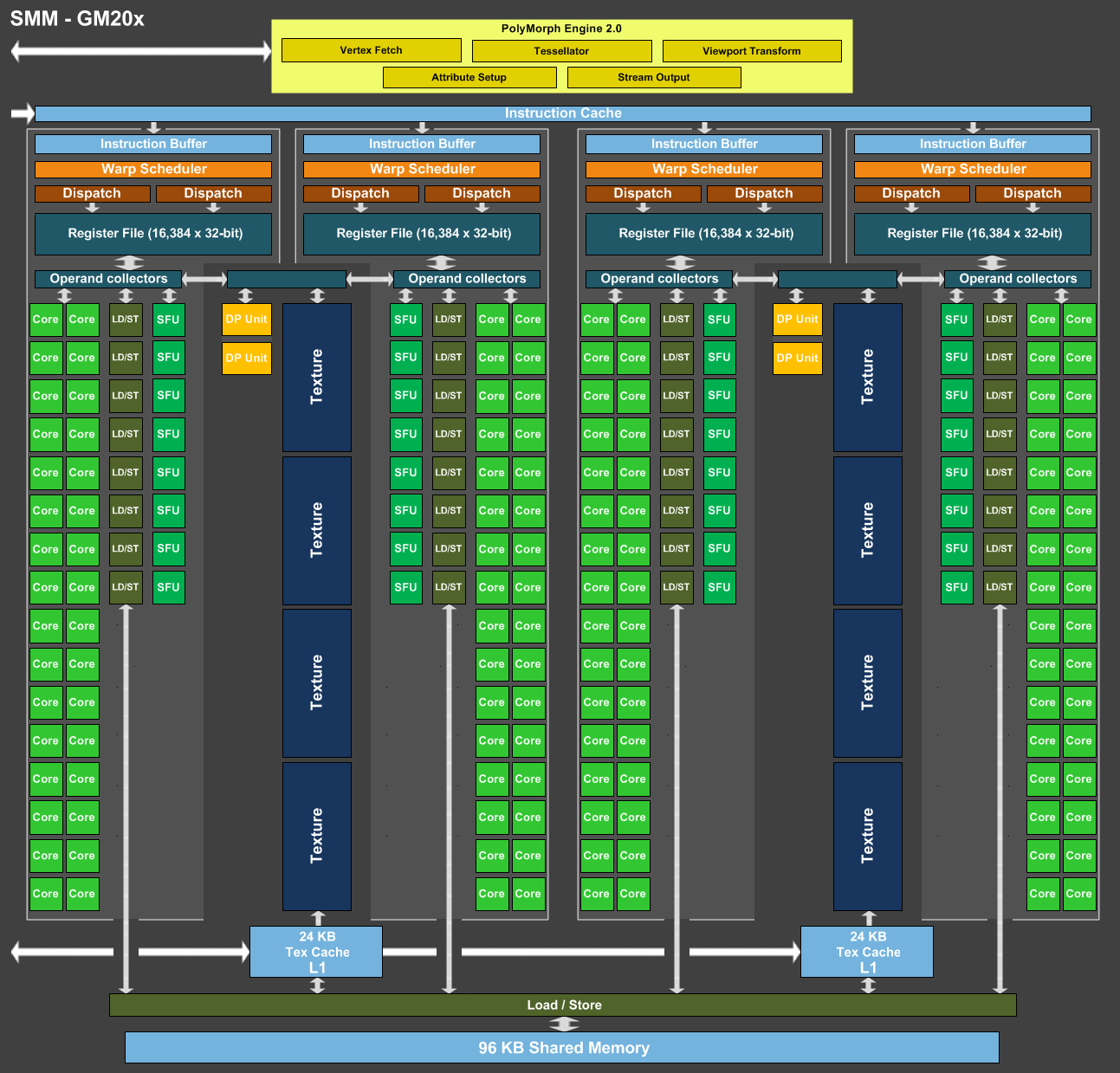

Fortunately, hardware.fr publications contained more exact picture of each SM, in particular for Kepler: http://www.hardware.fr/medias/photos_news/00/44/IMG0044011_1.jpg
Finally, starting with Maxwell, NVidia fixed their picture and started to show register file as individual per scheduler. See page 8 in documents below:
http://international.download.nvidia.com/geforce-com/international/pdfs/GeForce_GTX_980_Whitepaper_FINAL.PDF
And individual register file per scheduler means that warp cannot be quickly moved to other scheduler - it will require to copy all register contents. Or it will require to make all registers available to all schedulers, but this will require to make 4x more read/write ports (which is very precious resource) in the register file and in this case, it will be more logical to continue show register file as shared by the all schedulers
I agree that the individual register files on the maxwell whitepapers suggest that warps are assigned and probably do not move. I don’t have 100% confirmation of that.
The hardware.fr picture appears to show operand collectors, however, which may have some role in register data exchange.
Anyway, my purpose on these forums is not to take material non-published information about our GPU hardware and make it public. I would get fired for doing that, quick.
So if I can’t ascertain something from previously disclosed public information, it is rare that I would expose any non-public information here.
And in many cases I simply don’t know the answer and it serves little purpose for me to go and discover the answer within NVIDIA. Slideware has its limits, and non-published specifications are subject to change from chip to chip, from OS to OS, and from CUDA version to CUDA version, and in some cases from driver version to driver version.
Anyway I appreciate the collection of references, BulatZiganshin. I generally would agree with your conclusions, but that can’t be construed as any sort of statement of truth or official statement from NVIDIA. It may be the case that warps are assigned “statically”. It may also be the case that the specifics here vary from chip to chip.

A few extra detailed pictures:
And one of articles exposing them (just scroll down a bit):

The simplest way to track all these changes are pictures of various SM generations, especially the improved pictures provided by hardware.fr - once you learn how to interpret them, you will find there most of the info I provided here, and few bits on top of that (in particular, shared/L1$/Texture$ memory size and access).
Allow me to be a bit skeptical. Do we know the source for the additional information incorporated into hardware.fr’s improved diagrams? Did they design dozens of clever microbenchmarks to suss out the details, i.e. use reverse engineering?
CUDA C++ Programming Guide descriptions are hard to interpret otherwise than “scheduling was always static”:
I see that hardware.fr corrected some inaccuracies of original NVidia pictures so they better match what I know from other sources. They also contains other changes that I can’t clarify, but they look reasonable (f.e. split Tex$). So, i prefer them over original NVidia pictures.
