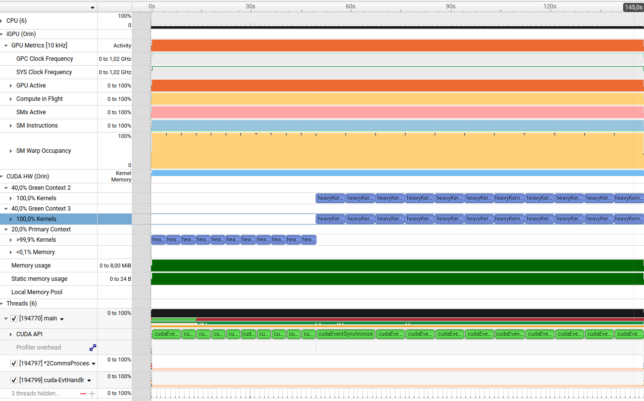

I’m experimenting with CUDA Green Contexts to assign a specific number of SMs to each context and run different kernels in parallel. However, I’m observing that regardless of how many SMs I allocate to each Green Context (via cuDevSmResourceSplitByCount), the execution time for the kernel remains essentially the same in both contexts.
Below is a simplified version of my code. I’m launching a computationally heavy kernel using two different Green Contexts, each associated with its own stream. I allocate only minCount = 1 SM to one of the contexts, while the other context gets the remaining SMs. I expected the kernel in the smaller context to take noticeably longer, but both timings are almost identical.
From what I’ve seen and based on the comments in the previous thread, it seems that the behavior I’m observing isn’t due to how Green Contexts work in general. Therefore, my follow-up question is:
Could there be any Jetson-specific considerations or constraints I should be aware of when using Green Contexts?
Or is it possible that I’ve made a mistake in my setup that I haven’t yet identified?

Have you tried to run a profiler on it to see if the utilization is expected?
Hi, first of all, thank you for your response.
I’ve run analyses using NVIDIA Nsight both with and without MPS, since I read that MPS could be necessary when trying to achieve kernel-level parallelism. I’m attaching screenshots of both cases.
Without MPS
With MPS
What I’ve noticed—and what confuses me—is that the kernel execution time is the same regardless of the number of SMs being used, and it’s always double the time compared to running the kernels separately. So, I’m not really gaining any benefit from using green contexts, with or without MPS.
It seems I must be doing something wrong, because I’ve been told that this approach works outside of Jetson platforms.
Thank you very much!

Have you run the profile with different green context settings to see if any difference in the resources that the app used?
Yes, I have tried all possible distributions within the 8 SMs available on the Jetson, but I haven’t seen any effect with any of them.

Average time for kernel A: 7015.74 ms
Average time for kernel B: 2345.49 ms
It looks like kernel A takes much longer than kernel B.
Does it use a smaller number of SMs?

We build the sample with the below nvcc command directly:
nvcc test.cu -o test -lcuda
Also test your Makefile (remove -ltorch -ltorch_cpu -lc10) and the results are similar to our previous.

Average time for kernel A: 7647 ms
Average time for kernel B: 2561.85 ms
