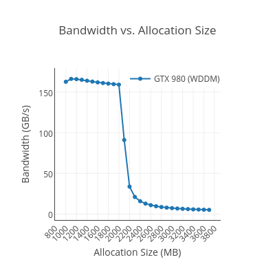

A headless 4GB GTX 980 (sm_52) rolls off strongly at 2048 MB:
With this new datapoint, I’ll let others make conclusions on where the roll-off will occur relative to total memory. :)
Tested with:
$> probe_bw <id> <1000-3700> 32
Win7/x64 + CUDA 7.5 + 358.50.
I think that was the preliminary conclusion drawn earlier in this thread. The issue manifests on various sm_50 GPUs, but so far nobody has been able to reproduce it on sm_52 GPUs. Although I have an sm_50 GPU in my system, I feel little inclination to dig further.
