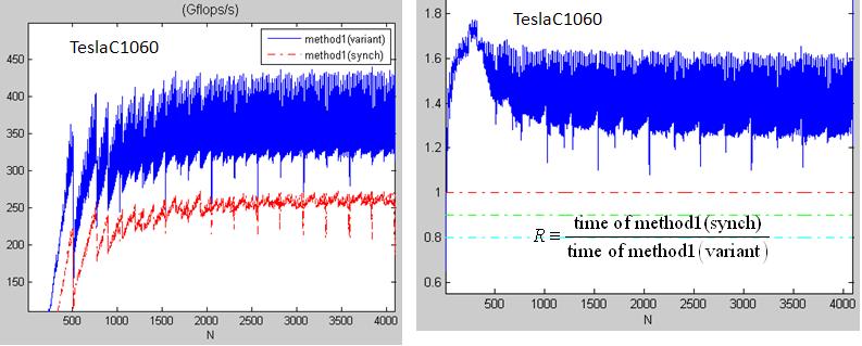

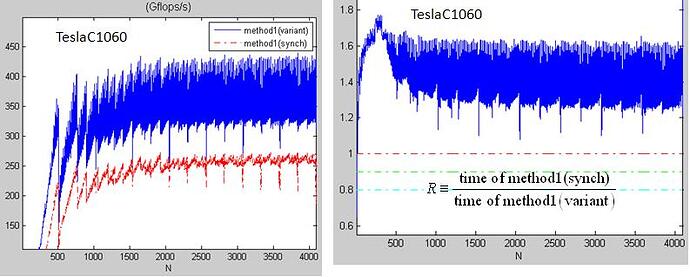

I try your suggestion, case 2, into my algorithm, method 1.
method 1 + __synch after “b_reg = b_ptr[j] ;”
b_ptr = (float*)b;
#pragma unroll
		for( int i = 0; i < BLOCK_SIZE_X; i++  ){
			float A0_reg = A[0]; A += lda;
			float A1_reg = A1[0]; A1 += lda;
#pragma unroll
			for( int j = 0; j < BLOCK_SIZE_Y; j++){
				b_reg = b_ptr[j];
				__syncthreads();
				c0[j] += A0_reg * b_reg;
				c1[j] += A1_reg * b_reg;
However nvcc reports error message as
tmpxft_00000bb8_00000000-3_method1_thread.cudafe1.gpu
tmpxft_00000bb8_00000000-8_method1_thread.cudafe2.gpu
nvopencc ERROR: C:\CUDA\bin64/../open64/lib//be.exe returned non-zero status -10
73741819
I disable fully loop-unrolling of outer loop and change outer loop to #pragma unroll 8
(BLOCK_SIZE_X = 16, BLOCK_SIZE_Y = 16). Also I use compiler option “-maxrregcount 48”,
such that number of active thread = 320 (register count per thread = 46 ),
the same as method1_variant in report.
The code is called method1(synch)
b_ptr = (float*)b;
#pragma unroll 8
#pragma unroll
				b_reg = b_ptr[j];
				__syncthreads();
I indeed obtain "shared memory —> register " from result of decuda.
However the performance in figure 2 is not good, only 250Gflop/s.
I think that this is because of too many __syncthreads().
figrue 2: performance comparison between method1(variant) and method1(synch)
method1(synch) only reaches 250Gflop/s, 30% slower than method1(variant).
In order to achieve high performance, we need to remove extra __synch operations.
However we must reset offset of jump instruction after removing extra __synch operations.
cudasm can configure offset of jump instructions but we need to check other binary codes
generated by cudasm.
Besides, there is one thing strange. if I unroll inner loop explicitly, then

Incorporating the 88% with clock cycle counting, I can accurately account for every instruction issued in the loop, where the syncthread() instructions accounted for 4cc per warp (which of course is the expected throughput)
However in my example, i have 1 sychthread against (27 MAD instructions + 27 MOV instructions), thus I only experience 1/55 = 1.8% slower code due to sycnthreads
thanks for trying, great job on the sgemm :thumbup:
Nikolai, thanks for explanation.
You are right, cost of __synch can be estimated.
In my code, 2 MADs + 1 Move when do a __synch, that means I have 1/3 extra performance degradation,
which matches experimental result.
So the key point is how many __synch we should pay.
oh geez you’re only doing 2 MAD? cuz then using syncthreads is not viable (i.e. your 30% reduction in speed), sorry about that :">
Great performance!
Note that peak performance in multiply-and-add is 624 Gflop/s with or without dual issue. Comparing to the 50% higher peak, which implies another multiply done in parallel, would be misleading for matrix-matrix multiply performance analysis - you can’t use that multiply anyway.
Then I wonder, if your 70% is the limit. If you know how to find the way around the “multiply-and-add with operand in shared memory” bottleneck, then you are no more bound by its 66% throughput. Why not push all the way up to, say, 90% of peak?

Thanks, you are right. In SGEMM, we always count number of MAD operations, so 624 Gflop/s is peak performance.
I check assembly code of my method 1, it has regular pattern, one “MOV reg, [smem]” and two “MAD dest, src1,src2,src3” interleave each other.
Such pattern is good for dual issue, I wonder if I can improve it, from 70% to 90%.
On the contrary, I also implment volkov_variant, which modifies “MAD dest, [smem], src2, src3” in volkov’s code into
“MOV reg, [smem]” and “MAD dest, src1,src2,src3”, however no speedup is seen in volkov_variant.
The reason is clear now since pattern of one “MOV reg, [smem]” and one “MAD dest, src1,src2,src3” is not regular,
several “MOV reg, [smem]” are grouped together (I think this is side effect of loop-unrolling).
It is necessary to write assembly manually in volkov_variant such that
one “MOV reg, [smem]” and one “MAD dest, src1,src2,src3” is regular.
Then we can check effect of dual issue on Volkov’s code.
Original Volkov’s code is more competitive since it has 512 active threads per SM.
I will re-survey cudasm and try to wrtie assembly manually and report the result later.
It may be not due to dual-issue then. One smem-MOV per two register-MADs means that you are using a kind of register blocking, which reduces smem traffic per flop. The problem may be not simply in MADs-with-smem-operand, but in accessing smem in parallel with MAD no matter how you do that - using one or multiple instructions. A kind of bandwidth bottleneck. In that case you might still get further speedup if you use larger register blocks - such as one smem-MOV per four register-MADs.
I also wonder why you get 55.45% on GT200 with my code. I get 60% on GTX280.
That is my original idea, reduce number of “reg <-- share memory”.
However under the case, “one smem-MOV per four register-MADs”, there are only 192 active threads per SM,
performance is not good.
I get about 55.4% on TeslaC1060, GTX295 and GTX285.
for dimension n > 2046, I execute SGEMM twice and average it.

The speedup in the paper is due to
(1) load 64-bit (float2) instead of 32-bit (float) and
(2) reduce number of _synch by using 16x32 sub-block
however MAD operation is fixed as c = ab + c, so "a=ba+b; b=a*b+a" is impossible in SGEMM.
I think that “reduce number of _synch” is a good point, I will try this.
