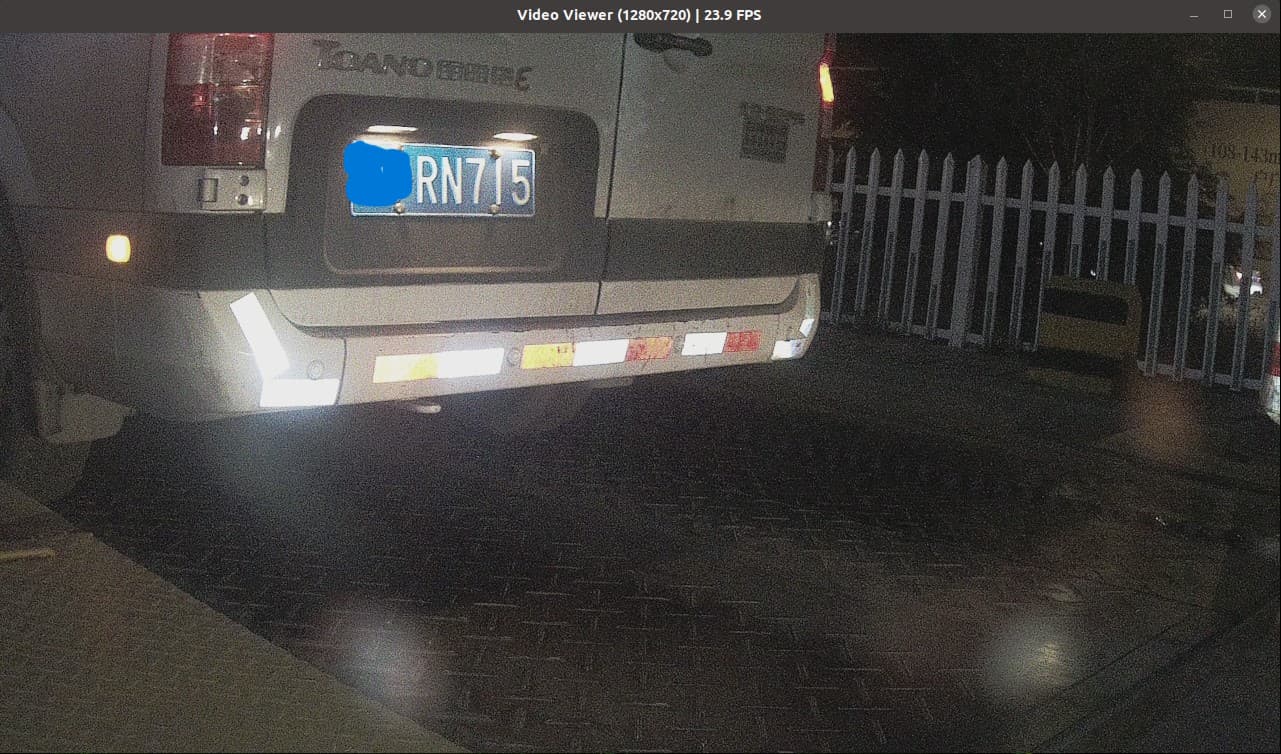

Hello, our team has developed the driver for the IMX327 camera for the Orin NX development board, and it has been correctly loaded onto the board. We can capture video with the camera using the video-viewer command. However, the image quality might need improvement. I noticed that NVIDIA provides the Argus API for the ISP process, and I have already run some examples under the Argus directory by installing the nvidia-l4t-jetson-multimedia-api package via sudo apt install. However, I still don’t fully understand how Argus works.

For the Bayer sensor you need to have camera partner for the IQ tuning.
If YUV sensor you need to external ISP vendor to help to improve the image quality.
Thank you for the response. The camera we are using is a Bayer sensor and does not have a built-in ISP module. So, what is the general purpose of the Argus functionality and API provided by NVIDIA? I always thought it was intended for developers to use to optimize image quality.

A large portion of the noise you see in your images is because you’re taking pictures of moving objects at night. Your camera is trying to balance gain and exposure time to get a bright enough image without motion blur.
If you camera is in a stationary position and you’re able to use a light, the easiest way for you to increase image quality would be to add lighting. Another thing you could do is move your camera to a position closer along the axis of motion of the object you’re imaging, this way you could increase the exposure time without getting as much motion blur, then you could turn down the gain. Basically move the camera to a position more behind (probably above) the cars passing by.

Thank you for your suggestion. Due to some engineering considerations, our camera is planned to be installed on the roadside, and lighting has already been set up. Previously, we used an IMX385 camera with a built-in ISP module, which allowed us to conveniently call the ISP for debugging and optimizing image quality. However, we are unsure whether, when using Argus to perform ISP, it is possible to further optimize the image quality.

Argus provide some basic function for noise reduce and sharpness enhance if those doesn’t acceptable the you need IQ tuning process by camera partner.
