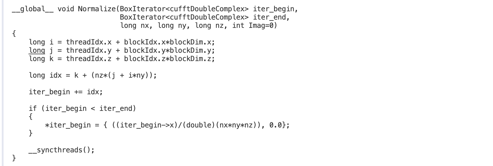

As per my understanding, here the cuCTXSynchronize time is not from the problem-specific kernels; It’s from CUDA API calls and also higher than the total time taken by all the problem-specific kernels. (Please see the below attachment for CUDA API call example and problem-specific kernel) Here, my main concern is that the 3D problem of a 512 * 512 * 512 system is faster on a single GPU using cuFFT than cuFFTMp on multiple GPUs.

The CUDA API profile is measured on the host. The kernels are measured on the device. They are distinct measurements that may be inclusive or exclusive of each other.
cuCtxSynchronize is the CUDA Driver API call used to block the host thread to wait on a GPU context operation to complete. Basically the same as the CUDA API’s “cudaDeviceSynchronize”. Hence kernels which are blocked (i.e. not async) will be included in the time reported by cuCtxSynchronize. Also to correct what I said before, the small difference between the two above may be due to other operations, like the host blocking on memory transfers, not just the overhead of waking up the host thread.
If you can provide a reproducing example, I can take a look or pass it on to someone more familiar with cuFFTMp.
