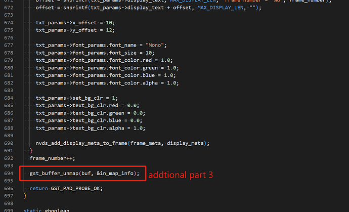

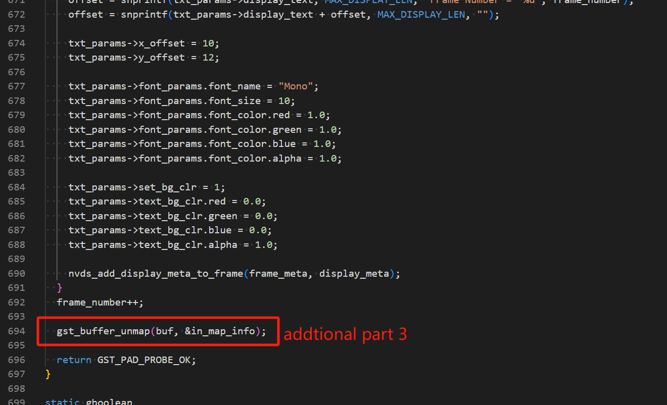

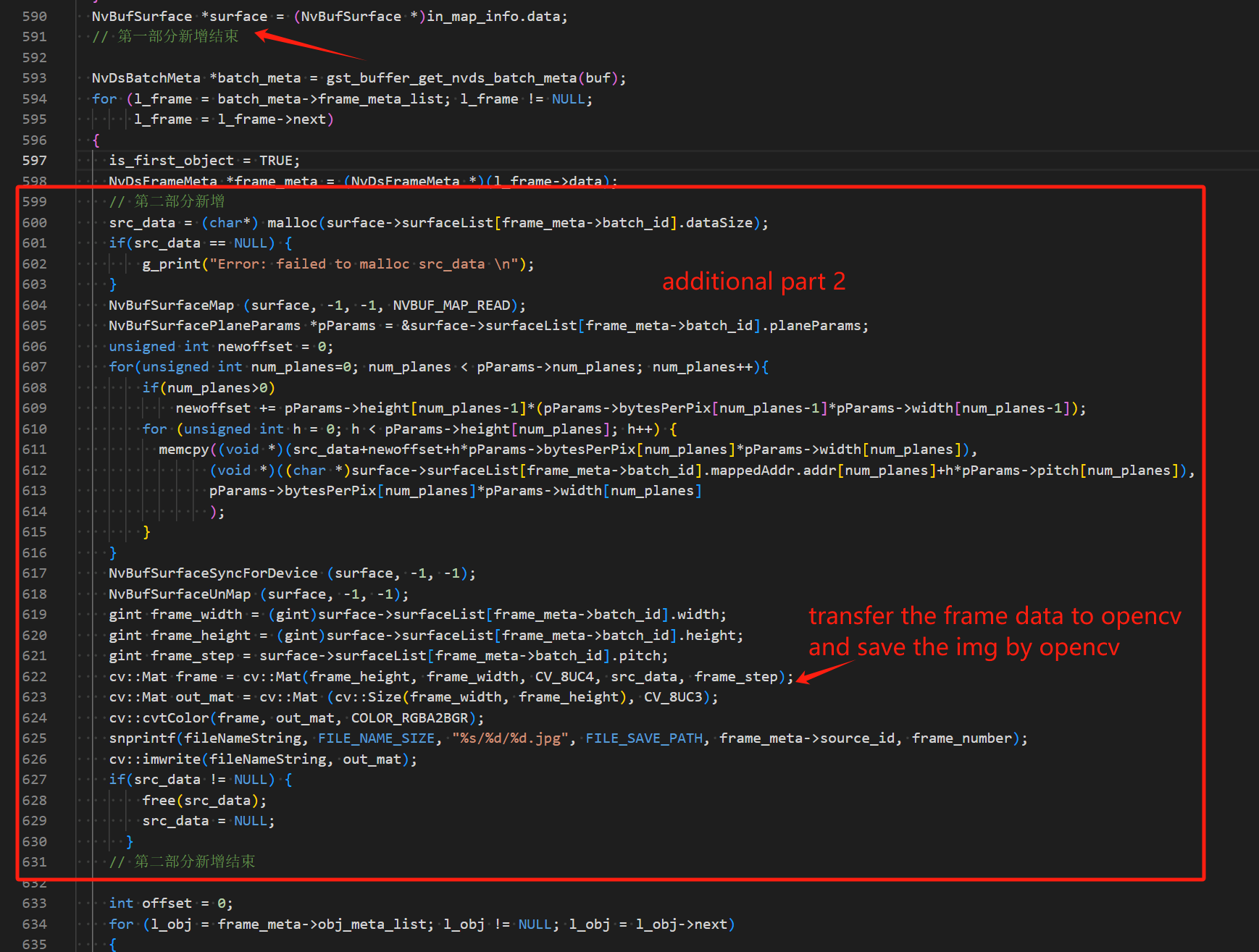

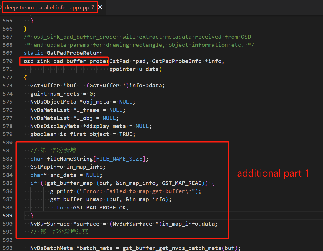

I just try to save original stream frames when run the code of deepstream_parallel_infer_app on Jetson Xaiver NX with Jetpack 5.1.1 and deepstream-6.2. But it seems the procedure would be blocked after runining a few time…
I here provide my addtional code for saving image as below:
I’m not clear whether I make something wrong or the additional code would cause some memory leak? Hope someone can help to correct me, thanks in advance!
