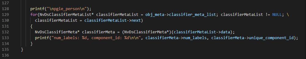

How to set the config file of sgie of multi label classifier?
Hi @489536658,
Could you clarify what you expect? Or, could you show what 's the correct output with DS4.0?
Hi, mchi,
now, the NvDsClassifierMetaList header is always null, or the NvDsClassifierMetaList is empty.
The expected result is that NvDsClassifierMetaList is not empty, and the code in for loop can be executed.

Hi @489536658,
Since there is not label file in config_infer_secondary_person.txt, in below attach_metadata_classifier() function, NvDsClassifierMeta can’t be configued due to – object_info.label.length() == 0 .
File: /opt/nvidia/deepstream/deepstream/sources/gst-plugins/gst-nvinfer/gstnvinfer_meta_utils.cpp
    void
    attach_metadata_classifier (GstNvInfer * nvinfer, GstMiniObject * tensor_out_object,
        GstNvInferFrame & frame, GstNvInferObjectInfo & object_info)
      NvDsObjectMeta *object_meta = frame.obj_meta;
      NvDsBatchMeta *batch_meta = (nvinfer->process_full_frame) ?
        frame.frame_meta->base_meta.batch_meta : object_meta->base_meta.batch_meta;
      if (object_info.attributes.size () == 0 ||
              object_info.label.length() == 0)
        return;
Ok, thanks!
Hi, mchi, in the comment of config file, the label file propety is optional, so is it ok without label file?
From the code I showd above, it’s not.
Could you give the label file and check again?
Hi, mchi, i have no label file, because the label file’s format of a multi label classifier is unknown
Hi @489536658,
Besides giving the label file, also need to set “process-mode=2” in config_infer_secondary_person.txt, otherwise, classifier gie will inference on full frame instead of the detected objects.
So, if you add below two lines in “config_infer_secondary_person.txt”, NvDsClassifierMetaList will not be NULL. However, you need to update labels.txt according to your model.
process-mode=2
labelfile-path=../../../../samples/models/Secondary_CarColor/labels.txt

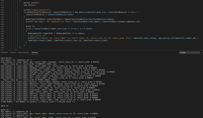

Hi, mchi, the attached file is our prepared label file, and now, the sgie of multi label classifier works fine, but the value of the attribute “num_classes” is always zero, could you please make a test?
what make you think num_classes must be non-zero?
Hi, mchi, according to the comment
Hi @489536658,
Confirmed that num_classes is not used now, it will be removed in future.
