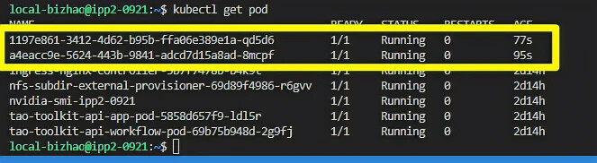

I confused about why every time I run this cell to create a job
It will create two pods, and one of the pod always get Error status then disappeared
and the monitor cell always stay on this response
here is the pod log of which status is Running,
Thank you for your patience~
pod_descibe (3.7 KB)
