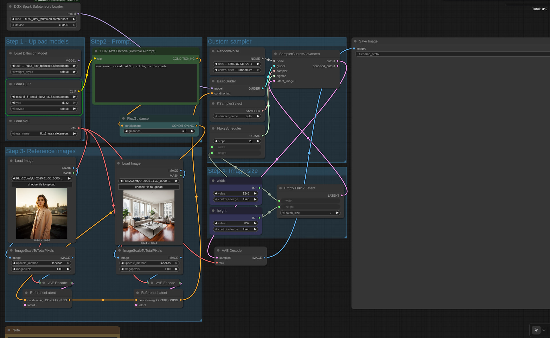

I wrote a custom node that loads .safetensors using the fastsafetensors library directly to VRAM from storage, bypassing any copies. This works exactly as expected on DGX Spark, loading the BF16 version of FLUX.2 in only a few seconds:

Apologies in advance, i’m still new to Linux in general. but how do you actually install and use this. I did the git pull and the directory is there. so i did the pip install -r requirements.txt and that seemed to work. But I’m still getting the out memory errors so I’m obviously missing a step. any help for a noob would be appreciated. thanks in advance.
Ensure you’re cloning the repo into ComfyUI/custom_nodes. After restarting ComfyUI, add add the new DGXSparkSafetensorsLoader node, which will replace the default “Load Diffusion Model” node. Connect the output of the new DGX loader to the rest of your workflow. That should do it:
I used your node, and it was still the same Killed
Are you using Flux.2? Post your workflow and I’ll have a look.
This node works for me, though the only annoying thing is that if you run another workflow after it then it tends to run out of memory because the node hasn’t released the memory for the Flux model. Maybe add a flush DGX model node or something?
Yep, you’re right. Unfortunately, I don’t know enough about ComfyUI to know how to keep a handle to the memory allocated by the fastsafetensors reader. I mention this on the GitHub site, and the workaround is to just quit and relaunch ComfyUI. I agree this is a pain and once I figure it out I’ll update the node to fix this.

link for a complete workflow ?
You should be able to use any basic Flux.2 workflow. Just replace the loader node with mine. Here’s an example workflow from the ComfyUI GitHub you can use as a starting point:
Again, just replace the model loader node.
