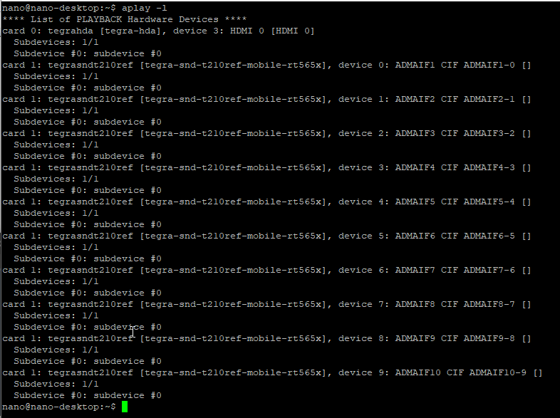

Hi guys please help me understand (noob here), I’ve been trying to get the I2s from the J41 header on my Jetson Nano A02 working with not success, after reading some post (Audio I2S on 40 Pin Connector - #26 by ABSOLUTLEY_DIAPPOINTED Enabling I2S Audio on Jetson Nano GPIO Header ) on this issue and I’ve started to think that or eighter I don’t get I2S or my Jetson is broken. Apparently, the command “aplay -l” should show the different cards, well in my case this is what comes out 1 card the HDMI:
**** List of PLAYBACK Hardware Devices ****
card 0: tegrahda [tegra-hda], device 3: HDMI 0 [HDMI 0]
Subdevices: 1/1
Subdevice #0: subdevice #0

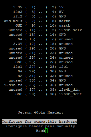

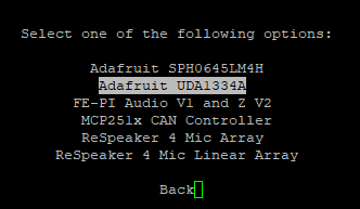

As an update, I managed to get the I2S working, I had to set the custom DTB using jetson-io to compatible with Adafruit UDA1334A
then manually configured pin 38 for IS24b_din.

Then to find what was the sound card name I used aplay -l which gave two cards
so to play the test.wav I used aplay -D hw:tegrasndt210ref,0 test.wav
