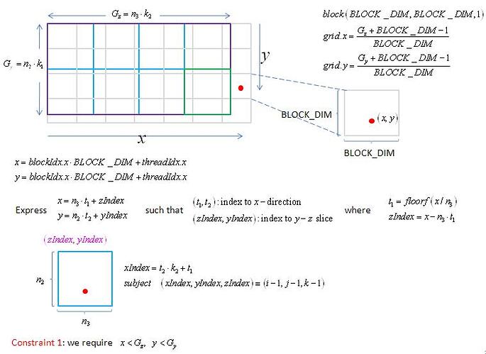

Dear all: I share my two ideas on 3-D data index map
method 1: naive map, create a 3-D thread box and map each thread to a data element, I use
figure 1 and figure 2 to illustrate the idea
figure 1
figure 2
above idea can be implemented via one kernel “naive_3D” and one C-wrapper “naive_3D_device” and
put these two codes into one .cu file.
type “doublereal” can be float or double, depends on your application

hence I provide another kind of map
method 2: typical map, it deal with y-z slice by slice along x-direction, I use figure 3, 4, 5 to illustrate the idea
figure 3
figure 4
figure 5
above idea can be implemented via one kernel “typical_3D” and one C-wrapper “typical_3D_device” and

remark 1: in typical method, I use “float” to do modulo operation, this is good for small Gy, Gz,
one can use “double” to do modulo operation (see naive method)
remark 2: in C-wrapper of typical method, I provide another approach to find pair (k1, k2),
this approach save resource but sometimes k2 may exceed 65535, one can use
k1 = (unsignedint) floor( sqrt(db_n1) ) ;
k2 = (unsigned int) ceil( db_n1/((double)k1)) ;
in fact, experimental result shows no difference between two approaches for (k1,k2) computation.
Nice diagrams, thanks for posting!
@LSChien
Nice work! Which tool did you use to create these diagrams?
Bye,
amadea
microsoft Powerpoint

	double tmp1;
	unsigned int t1, xIndex, yIndex, zIndex, index_in, index_out, gridIndex;
// step 1: compute gridIndex in 1-D	and 1-D data index "index_in"
	gridIndex = blockIdx.y * gridDim.x + blockIdx.x;
	index_in = ( gridIndex * BLOCK_DIM_Y + threadIdx.y )*BLOCK_DIM_X + threadIdx.x;
// step 2: extract 3-D data index via
//	 index_in = row-map(i,j,k) = (i-1)*n2*n3 + (j-1)*n3 + (k-1)
// where  xIndex = i-1, yIndex = j-1, zIndex = k-1
	if ( index_in < sizeOfData ){
		tmp1 = __uint2double_rn( index_in );
		tmp1 = tmp1 * one_over_n3;
 		t1 = __double2uint_rz( tmp1 );
 		zIndex = index_in - n3*t1;
		tmp1 = __uint2double_rn( t1 );
		tmp1 = tmp1 * one_over_n2;
 		xIndex = __double2uint_rz( tmp1 );
 		yIndex = t1 - n2 * xIndex;
 		... your code
 	}// for each valid address

I’m hoping to use this indexing code to transpose 3D arrays, just as you say: A(i,j,k) → B(j,k,i).
If I’m right, all I need to add to the kernel typical_3d is:
[codebox]index_in = ( xIndex * n2 + yIndex )*n3 + zIndex ;
index_out = (yIndex * n3 + zIndex )*n1 + xIndex ;
dst[index_out] = src[index_in];[/codebox]

sorry, I post “method 2” to demonstrate copy routine.
If you want to do A(i,j,k) → B(j,k,i), then you must use x-z slice along y-direction, just a slightly modification of method 2.
besides I write a simple description for method 3 (this is my original idea, variant of method 2) in
http://oz.nthu.edu.tw/~d947207/NVIDIA/copy…nspose_post.pdf
and source code in http://oz.nthu.edu.tw/~d947207/NVIDIA/copy…se3D_revised.cu
