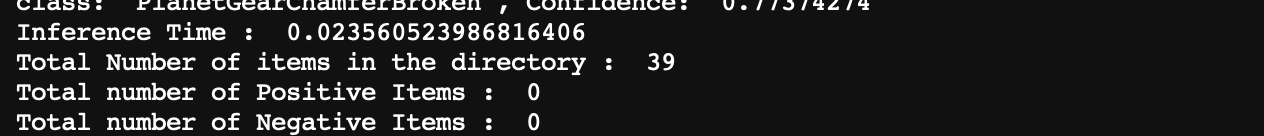

hey after running your script on my classification model I am getting one class always and also 0 positive negative values like this .
Any idea?
@senbhaskar26 ,
Yes, that script was made for testing my model… i had 2 classes “positive” and “negative”… you can edit with the name of your classes…
thanks got it working for my model. @jazeel.jk
