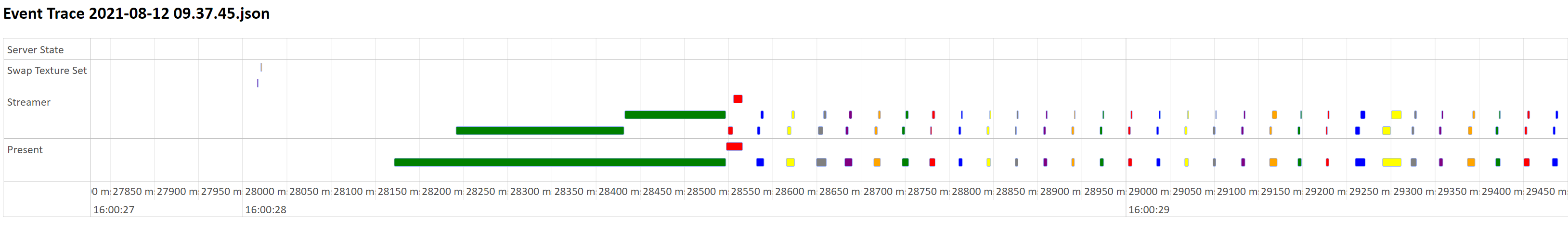

Following up, it looks like my trace does not match what the documentation example looks like.
Here is the example from the documentation…
And here is my trace…
The server state goes from 2 (ready) to 3 (HMD Active) and then looks like it dies?
Event Trace 2021-08-11 04.01.29.json (206.5 KB)

Hello @Veronica_NVIDIA,
I have successfully deployed this update to iOS and Windows without changing any of my dev environment to no effect. The results are the same. SteamVR does not display any connected controllers nor a “CXR” icon headset, but instead just an generic headset icon. I get transform data but nothing else.
Thoughts?
I can see based on the -d command that the following images are being sent, but apparently not recieved on the iOS device or not composited/displayed.
I am attaching new logs from your 2021-08-04 hotfix release.
