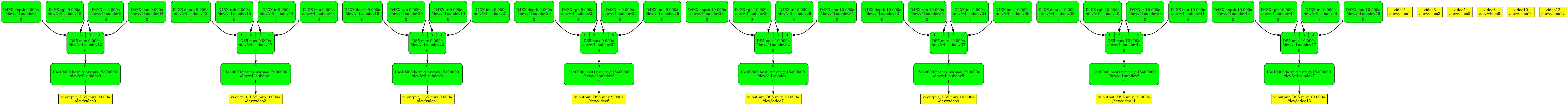

I checked the output of media-ctl like you mentioned and it looks fine to me; nothing obvious stands out.
Do you have any advice on how to troubleshoot this issue further?
