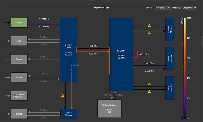

L2 Bandwidth Value for A100 Calculation
I have read several topics in the forum and used some of the repos from the GitHub. I can’t seem to get anywhere close with the +5 TB/s L2 cache bandwidth values.
Currently I am using a modified version of the code provided topic here and it was achieving 2.5 TB/s and now in my measurements it is achieving ~3.9 TB/s. Which is still quite low and the size change to 150 MB still provides 3.9 TB/s which shouldn’t be the case since it is greater than L2 cache size for Nvidia A100 ( 40 MB) and it should be DRAM bandwidths around 1.3 TB/s I would expect.
Modified Code:

Which is still a bit off and not perfect but it shows the drop at around 40 MB which makes sense.
What could be the solution here ?
The A100 has a split L2 cache of 2x20MB with overhead and doubled cache entries, when accessing the wrong half.
Perhaps partitioning with MIG could help just accessing the correct half? NVIDIA Multi-Instance GPU User Guide r560
Hi @Curefab ,
Would that mean if I decrease the size to 8 MB then it is going to end up in one bank ? Since the size change is not affecting the bandwidth is also worrying.
When I check with nsight compute it shows relatively lower bandwidth compared to calculated one :
As long as you have 988 GB/s communication between the two regions, which is half of your data bandwidth between L1 and L2, you are using both regions equally.
Each SM is connected to one of the two L2 regions.
And I think (but am not sure) that each address in global memory is linked to one of the two L2 regions.
With MIG you could separate the global memory regions, SMs and L2 regions at the same time.

Thank you for the insight and help. Tried the MIG but since I am using a HPC system I don’t have rights to set it on on the GPU node I am using. So I believe I require a algorithmic solution which would take into account this banking scenario
You can read the SM number, e.g. %smid, and try to find out, which SM ids show similar behavior (for the same memory addresses) and belong to the same half.
The memory addresses probably are virtual and I do not know, if the distribution between the two L2 regions is done with large blocks (e.g. size of gigabytes) or smaller units (e.g. each 128 bytes they switch).
