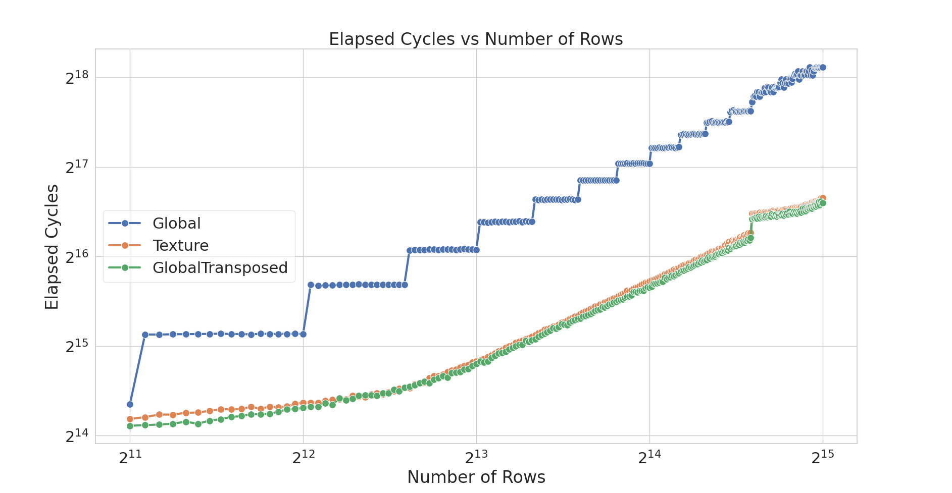

  2. I also observed an interesting scaling pattern in kernel cycle count. When varying the number of rows:
    • On an RTX 3050 Laptop GPU (16 SM × 128 CUDA cores), the total cycles increase in steps of 2048 rows.
    • On an RTX 4080 GPU (76 SM), the step size becomes 9728 rows.
    • In contrast, a column-sum version of the kernel (where accesses are coalesced) shows smooth scaling with no such steps.
Why does this stepwise increase occur? It seems to align with the total number of CUDA cores, but I would appreciate any insight into why that correlation appears.

  1. I also observed an interesting scaling pattern in kernel cycle count. When varying the number of rows:
This is due to occupancy. The reproducible shows a blockDim of 128 threads.
  • 2048 = 16 SMs x 128 threads/block
  • 9728 = 76 SMs x 128 threads/block
    As more warps are added to the SM there is more ability to hide latency. When the row count exceeds 1 wave of thread blocks there will be another major cliff and the latency will increase linearly with the number of waves of thread blocks.

About the Stepwise Scaling in Kernel Cycle Count
I understand your explanation that the step size (e.g., 2048 rows on RTX 3050, 9728 on RTX 4080) corresponds to a “wave” of active thread blocks filling all SMs once.
However, I still have some doubts about why the step effect is much more visible in the uncoalesced sumRows case than in the coalesced sumCols (GlobalTransposed) version.
  • Could the stronger step pattern in sumRows be due to the LSU replay overhead — that is, since uncoalesced accesses occupy the LSU for more cycles per warp, fewer independent warps are able to hide latency effectively, so performance becomes more sensitive to occupancy “waves”?
Additionally, I tested allocating A in texture memory instead of global memory.
In that case, the step pattern almost disappears (though there’s still an interesting cliff near 2^14 + 2048 x 4 rows on the RTX 3050, and near 2^17 rows on the RTX 4080).
After that cliff, the step pattern for global memory also becomes less pronounced.
  • Would you have any insight into what might cause this cliff and the apparent “smoothing” of the steps afterward?
This is also a good question. I think the primary issue is that your memory requests are so inefficient in the uncoalesced manner both in L1TEX tag and miss stage and in the fill return stage. With the fully coalesced a single instruction is taking 1 cycle through L1TEX tag and miss stage and the L2 is returning 4 x 32B per request which is scattering the return data over the 4 sectors on return. I think this would be even more obvious on a 100-class part where each SM can received L2 fill at a higher rate.
In order to provide more information on your nice charts I would need to review the kernel in more detail and think through various limits and look at some profiling reports. I think Global is either latency bound or LSU bound. I think GlobalTransposed (assume this is coalesced) and texture is more likely memory bound so there is closer to a linear relationship between rows and cycles.
When it goes off the cliff I expect the grid is getting to multiple waves or there is tail effect starting. If you run this through NCU it would be interesting to look at the PM sampling (periodic sampling of PM counters) for sm__warps_active (or warp occupancy), L1TEX metrics, L2 metrics, and DRAM metrics especially at the end of the kernel. sm__warps_active should be able to clear show the steps.
Due to the address divergence in each request the LSU pipe is going to be stalled for 32 cycles and the return from L2 will be 1 sector per cycle so a single instruction will take a minimum of 32 cycles on fill followed. This will spread out the return to the warp resulting in long_scoreboards on LDG2, 3, and 4. The fact that warp 0, 1, 2, and 3 will be interleaved will increase the return latency between each LDG for a specific warp.
I believe this is the answer to this topic. Many thanks!
Exactly, that makes perfect sense! The number of active warps lining up with those cliffs really helps clarify the pattern I was seeing.

It’s also very surprising to me that texture memory gets that close to the coalesced implementation. As far as I know, 2D texture memory places vertically adjacent elements (in particular, an 2 x 16 bytes small matrix) within the same sector when fetched into the L1 cache (or, more precisely, the texture cache), so the number of requested sectors is reduced from 32 to 16 compared with the uncoalesced version. However, the reduction in cycle count is so significant that it’s very similar to the coalesced case. May I ask why texture memory behaves so differently from global memory in this specific case?
