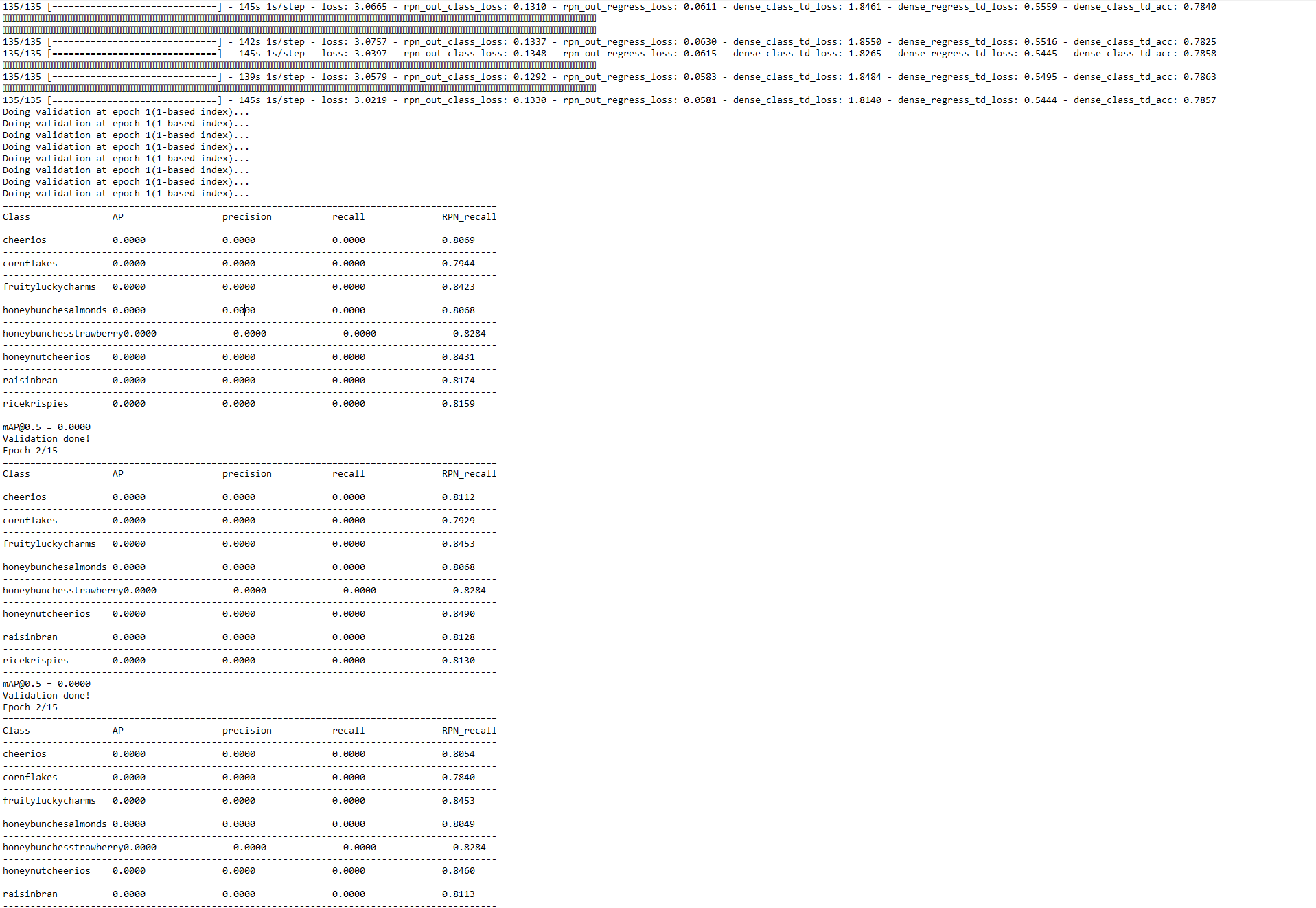

I am experiencing weird results when going from 1 or 2 gpus to 8 gpus when training a FasterRCNN model in TLT 3.0.

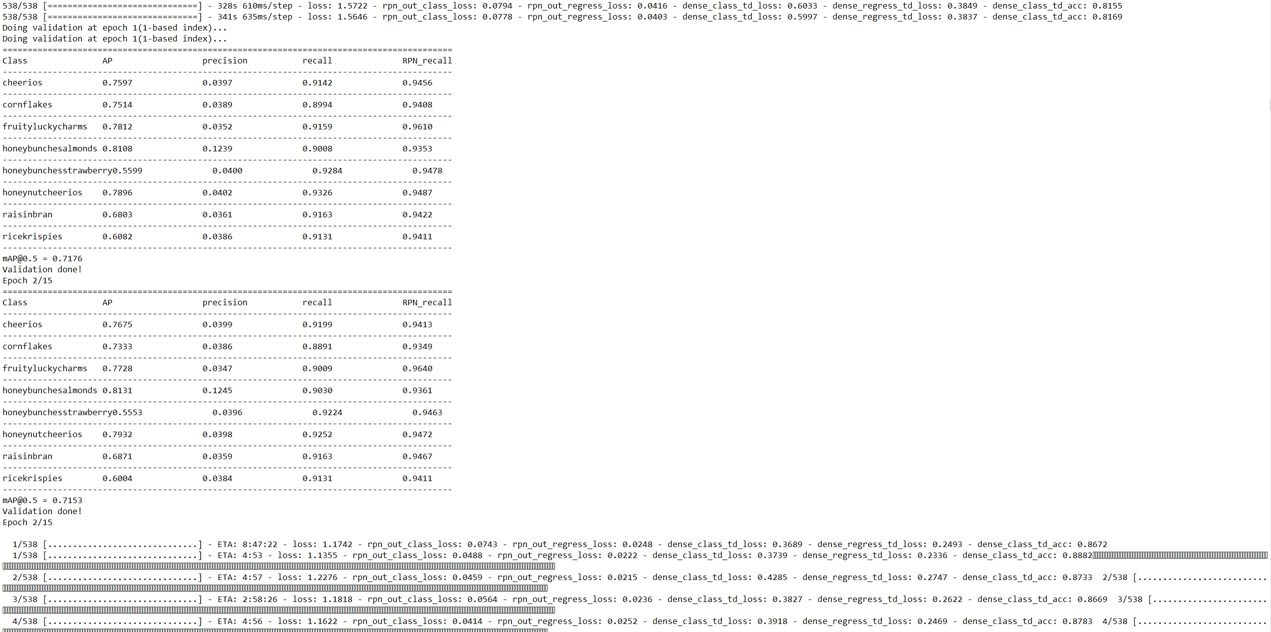

When I train the model with just 1 or 2 gpus, I get expected validation scores (e.g. mAP). However, when I train a model on the same dataset & same specs - but with 8 gpus - I get 0.0s in all the validation metrics.
My immediate thought is that something is going wrong during the training process, however, the loss scores provided during each epoch seem to be fine. It’s just the validation scores that get messed up.
Additionally, the 8gpu-trained model fails to make any inferences when running tlt faster_rcnn inference on a dataset in which the 1gpu and 2gpu -trained models do fine with. That is, the inference commands runs to completion no problem. It just doesn’t make any predictions.
Could you help resolve why our model fails when trained with 8 gpus?

Can you share the training spec with 8 gpus?
I think it is necessary to finetune the batch_size_per_gpu and lr.

Could you trigger experiments to finetune the lr? For example, try a lower lr.
sgd {
lr: 0.01
