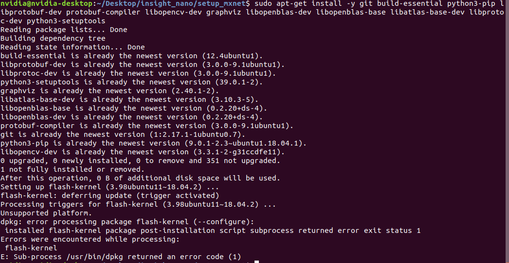

I run script but error.
Also, I have problem with flask kernel
Thank.
Based on the log, it seems that you try to flash kernel.
Do you execute other command on the same time?
No, I don’t
Sorry for the late update.
There is a missing c++ based library.
Would you mind to install it first and run the script again?
$ sudo apt-get install protobuf-compiler
I built successful with this doc.
