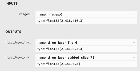

I try to convert the save_model to trt, after convert to onnx, i add BatchedNMS_TRT ;

  • but when I convert the onnx to trt failed;
    /usr/src/tensorrt/bin/trtexec --onnx=www3_fix.onnx.nms_test.onnx --fp16 --saveEngine=add_BatchedNMS_TRT.engine --shapes=images:0:2x416x416x3 --verbose --explicitBatch
  • my Jetson’s TensorRT Version:7.1.3
    I am sure that the BatchedNMS’s input shape is [batch_size, number_boxes, number_classes, number_box_parameters]
