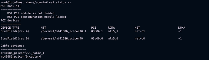

We bought a Bluefield 2 MBF2H516A-EEEOT with PSID: MT_00000478.

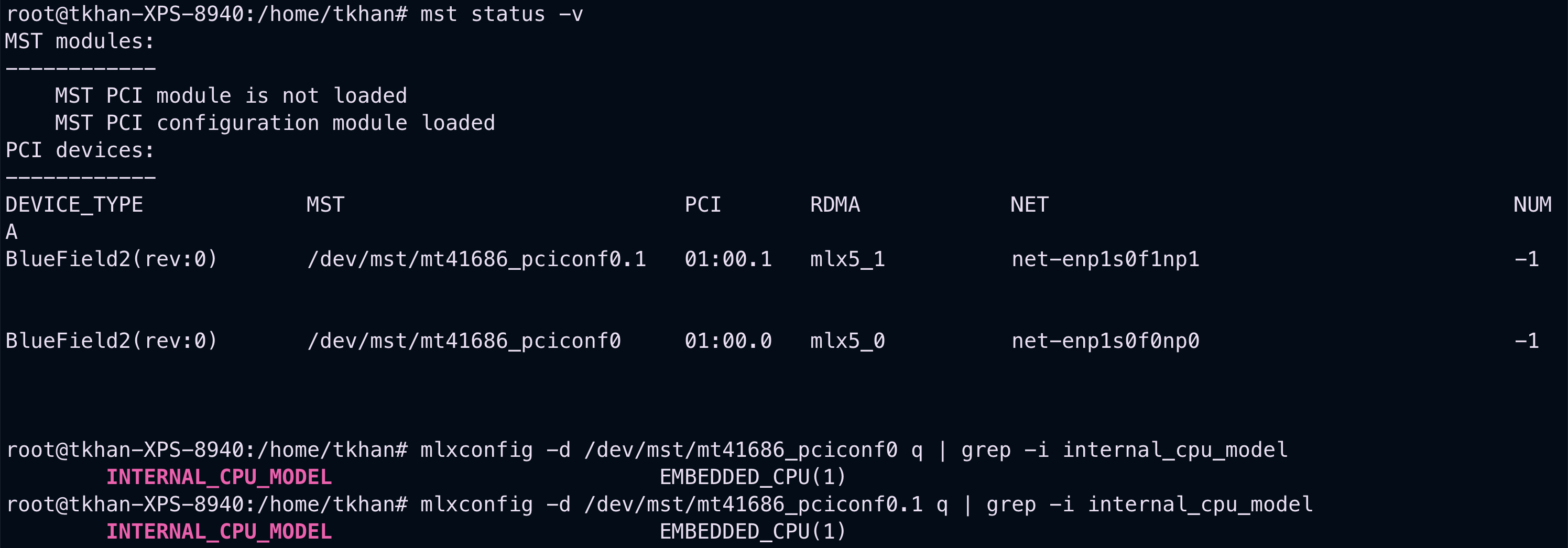

When I switch the Bluefield 2 to EMBEDDED_CPU mode, I cannot find the interfaces pf0hpf/pf1hpf from ARM side. The output of mst status -v is as follows.
HOST:
Bluefield 2:
The 2 physical ports are Ethernet, and be connected back-to-back with a CX6DX.

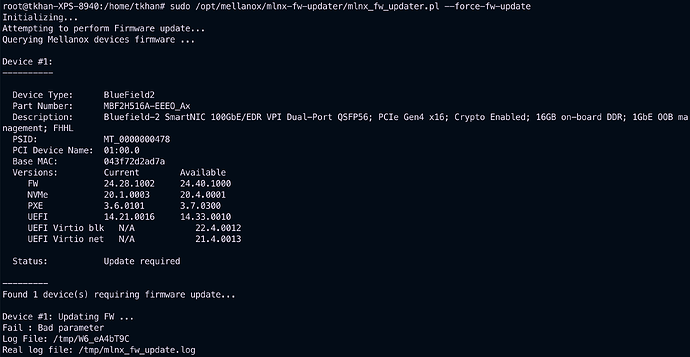

Also, I cannot update the firmware for Bluefield 2 either. No firmware version matches the PSID MT_00000478. The listed firmware for MBF2H516A-EEEOT on Nvidia website has PSID MT_00000704, which cannot be burned due to mismatch PSID.

Hi @tmatuan96
The latest BFB images with included firmware can be found in the “BlueField DPU Runtime and Driver Downloads” section of the following page:
https://developer.nvidia.com/networking/doca
Additionally for further debugging you can open a support case we will do our best to assist you asap.
Just send email with the issue description to Enterprise Support EnterpriseSupport@nvidia.com
Regards,
Vladislav
man , your firmware is too old , you can not upgrade to DOCA-2.6 from a very old version , you must upgrade to DOCA 1.5.X firstly then you can upgrade to DOCA-2.6
