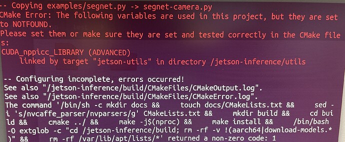

I have built the docker, however, it gives me some errors at the end.
What could it be?
Ah, ok. You need to set your default docker-runtime to nvidia like shown here: https://github.com/dusty-nv/jetson-containers#docker-default-runtime
Then reboot or restart your docker service. Then try docker/build.sh again.

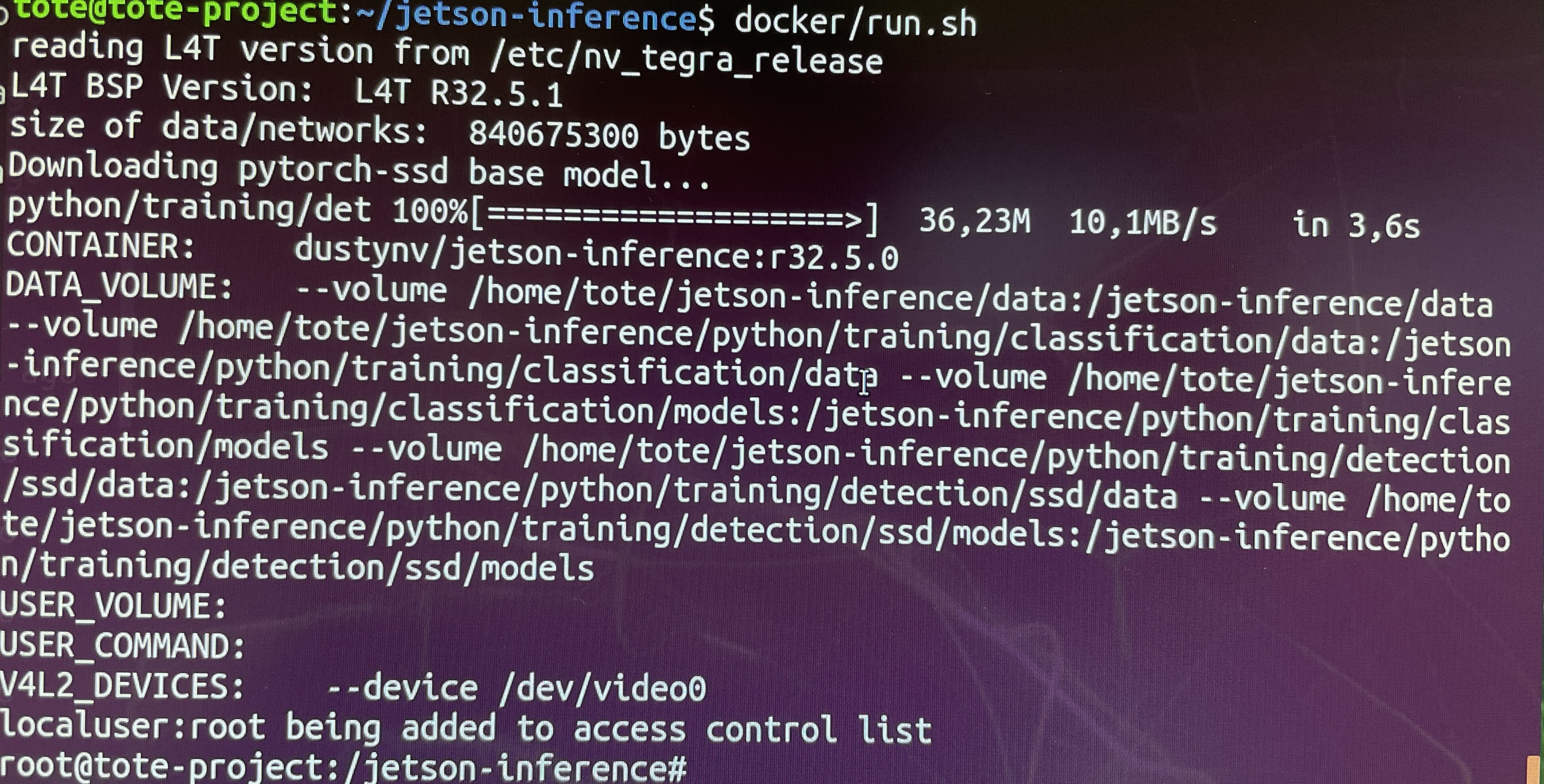

I have done what you suggested, I have built the docker with no errors, however when I run the docker normally “docker/run.sh”, it still is the same, the detectNet.cpp file and the detectnet.cpp file, when I view the from the container using “cat detectNet.cpp” command, it shows the original version without my edits, and indeed when I run my model, it still is the same with no changes, I also tried to change a bit of the text from the detectnet.cpp file, just to see some feedback, but nothing, it does not seem to change, no matter what I do.

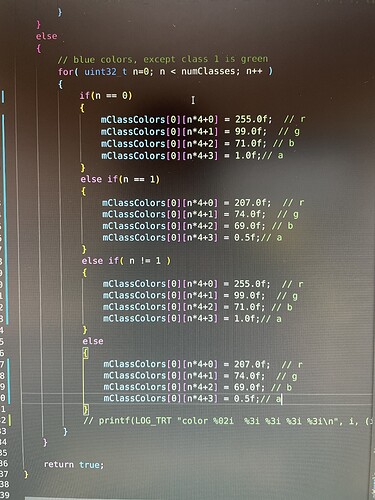

I am trying to change the bounding box colors, nothing that complicated too.

Also, would you mind telling me if this is correct?
I am trying as said to change the bounding color boxes as I only have two classes, the colours are yellow and green apparently, and I would like to change the green to red, I guess I am in the right spot, but maybe I am wrong(?)
Hmm ok. For some reason, it is still running the original container from Dockerhub (even though the script looks for local container). Can you try running it like this instead? This should run the local container that you just built:
docker/run.sh -c jetson-inference:r32.5.0
Then see if your changes are in there.
I think you want to edit the code slightly above this, at line 486:
https://github.com/dusty-nv/jetson-inference/blob/2fb798e3e4895b51ce7315826297cf321f4bd577/c/detectNet.cpp#L486
for( int i=0; i < numClasses; i++ )
	if( n == 0 )
		mClassColors[0][i*4+0] = 255;
		mClassColors[0][i*4+1] = rgb[1]; = 99;
		mClassColors[0][i*4+2] = rgb[2]; = 71;
		mClassColors[0][i*4+3] = 255;
	else if( n == 1 )
		mClassColors[0][i*4+0] = 207;
		mClassColors[0][i*4+1] = rgb[1]; = 74;
		mClassColors[0][i*4+2] = rgb[2]; = 69;
		mClassColors[0][i*4+3] = 127;
	else
		uint8_t rgb[] = {0,0,0};
		GenerateColor(i, rgb);
		mClassColors[0][i*4+0] = rgb[0];
		mClassColors[0][i*4+3] = DETECTNET_DEFAULT_ALPHA;
		//printf(LOG_TRT "color %02i  %3i %3i %3i %3i\n", i, (int)r, (int)g, (int)b, (int)alpha);
Also note that the alpha values should be in the range of [0, 255]
