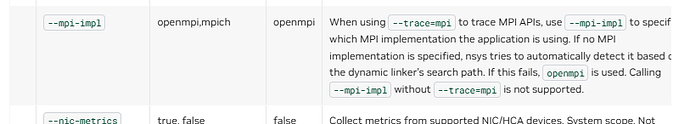

Can you try again explicitly setting the mpi type? this shouldn’t be an issue, but might be worth a check.
hi, I use this script:
nsys profile --trace=cuda,mpi --mpi-impl=openmpi --force-overwrite=true -o myprofile-openmpi mpirun --use-hwthread-cpus -np 4 ./main > SCREEN &
and it still doesn’t show MPI API

Nsight Systems uses LD_PRELOAD to inject the MPI tracing. How is MPI loaded/setup in your execution environment? How does the execution of your “real” app differ from the execution of your test app?
