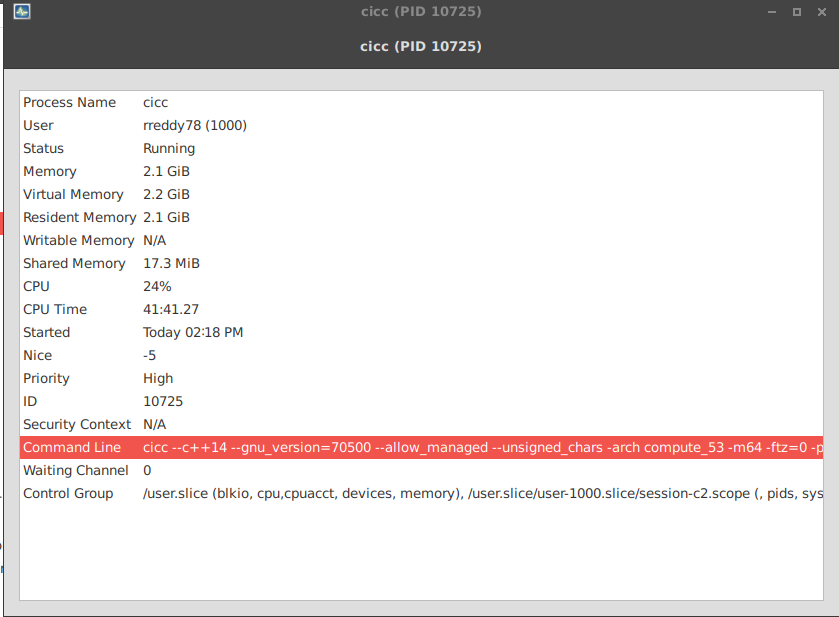

I am facing a strange issue with the nvcc compiler with one particular program. Nvcc does not complete at all and one core is at 100% use. I checked for 1 full min. It’s a small piece of code that should take 4S. Is it possible that an infinite loop has been triggered ?
The problem is the #pragma unroll within a nested loop.
With the #pragma unroll it takes around 4mins for compilation. Without the #pragma it takes just 4S! There is some exhaustive search going on in the compiler…

There might be a performance problem with nvcc after all…
There are times when #pragma unroll can lead to not completion at all ?
Code : NVIDIA, please check if reproducible on a jetson nano…
