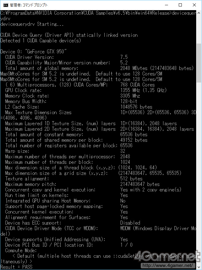

Can Nvidia release a white paper or post the output of ./DeviceQuery on the 1080/1070 when they get a chance?
I’m dying to get more details as to what in the world is going on inside that card as I would like to consider it for cuda development.
It’s a no go until I understand how exactly its different architecturally w.r.t to the cuda execution pipeline.
I’m surprised at how scant the details have been with relation to specs on the card.
Does it at least have dual copy engines like the previous 980?
If not, how can there be a claim of asynchronous compute?
What about runtime limits on kernel execution… etc etc.
What new features are being added to the card?
Are you guys removing any features that were already present on the 980/980ti/titanX ?
Lets get some details for the tech minded portion of your consumer base.
All that info is under NDA until May 17th, reviews will be up then.
As for dual copy engines, even the lowest end GM206 GPUs has it.
So Pascal should have it, after all it’s Compute Capability 6.x, higher than Maxwell’s 5.2.

sm_61 = sm_50 + fp16x2?
It will be interesting to see how code optimized for Maxwell runs on Pascal. In one of my projects I push on the max shared memory limit per SM (a large shared memory scratch pad per thread block) and that code will probably have to be adjusted to reduce the shared memory requirements.
GP104 is Compute Capability 6.1, but the devicequery is from CUDA Toolkit 6.5 so it might not properly support Pascal, might need to wait for CUDA Toolkit 8.0’s devicequery.
