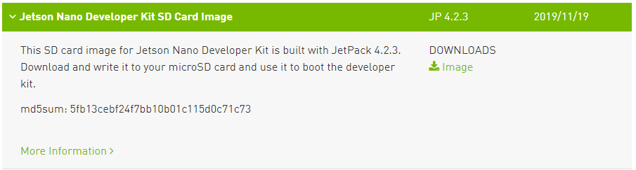

Jetpack 4.2.3? Does it pertain to sdcard image or sdkmanager? Both? Any? Or neither of the two?

To clarify, I got the disk image with JP 4.2.3. from the Jetson Download Center. The selection to download this disk image looks like the image below.
https://user-images.githubusercontent.com/19712696/71769828-c5e0dc00-2ef3-11ea-817f-b286b19745f7.png
Below is a hyperlink to download that image.
https://developer.nvidia.com/jetson-nano-sd-card-image-r3223
I am not sure why it is not available in the SDK Manager.
