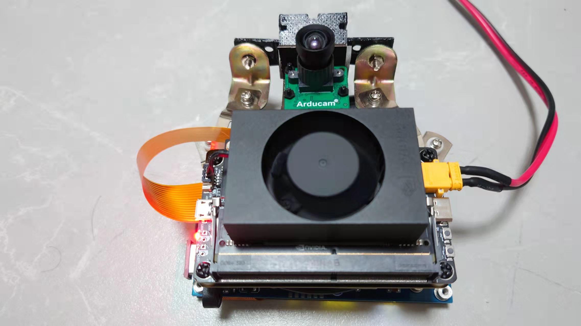

I’m here to share a project I’ve been working on over the last couple of months:- Running commaai openpilot on Jetson Xavier NX.
openpilot is an opensource ADAS solution by commaai (founded by George Hotz) and is rated No. 1 by consumer report
This build is based on dragonpilot - an openpilot fork that I’ve been maintaining for over 2 years.

Hi Rick,
Please provide hardware connection block diagram between Jetson Xavier NX, Comma.ai panda, camera and car.
I have white panda. What code customization required?
Can I use Rapberry Pi v2 camera instead of Arducam IMX 477 camera?
I am also interested to try it out.
Thanks,
sind-hem
Hi @sind-hem ,
Sorry for the late reply as I had trouble signing in over the last few days :(
Please see the diagram below:
if you only have a white panda then you probably need a giraffe so it can be set in between the ADAS CAMERA and CAR to intercept and modify the control messages.
you can still do it without a giraffe but you will need to figure out the wiring yourself.
The stock openpilot no longer supports white panda so you will need to modify selfdrive/boardd/panda.cc to bypass checking, I’ve already done it in the xnxpilot but I only tested in on bench so can’t guarantee anything.
Any camera will do I suppose as long as it’s 1080P or above. I’ve tried IMX219 and IMX477 but I ended up keeping IMX477 because of its lens. The one on IMX219 doesn’t have enough FoV (I think) and causing lots of calibration issues.
