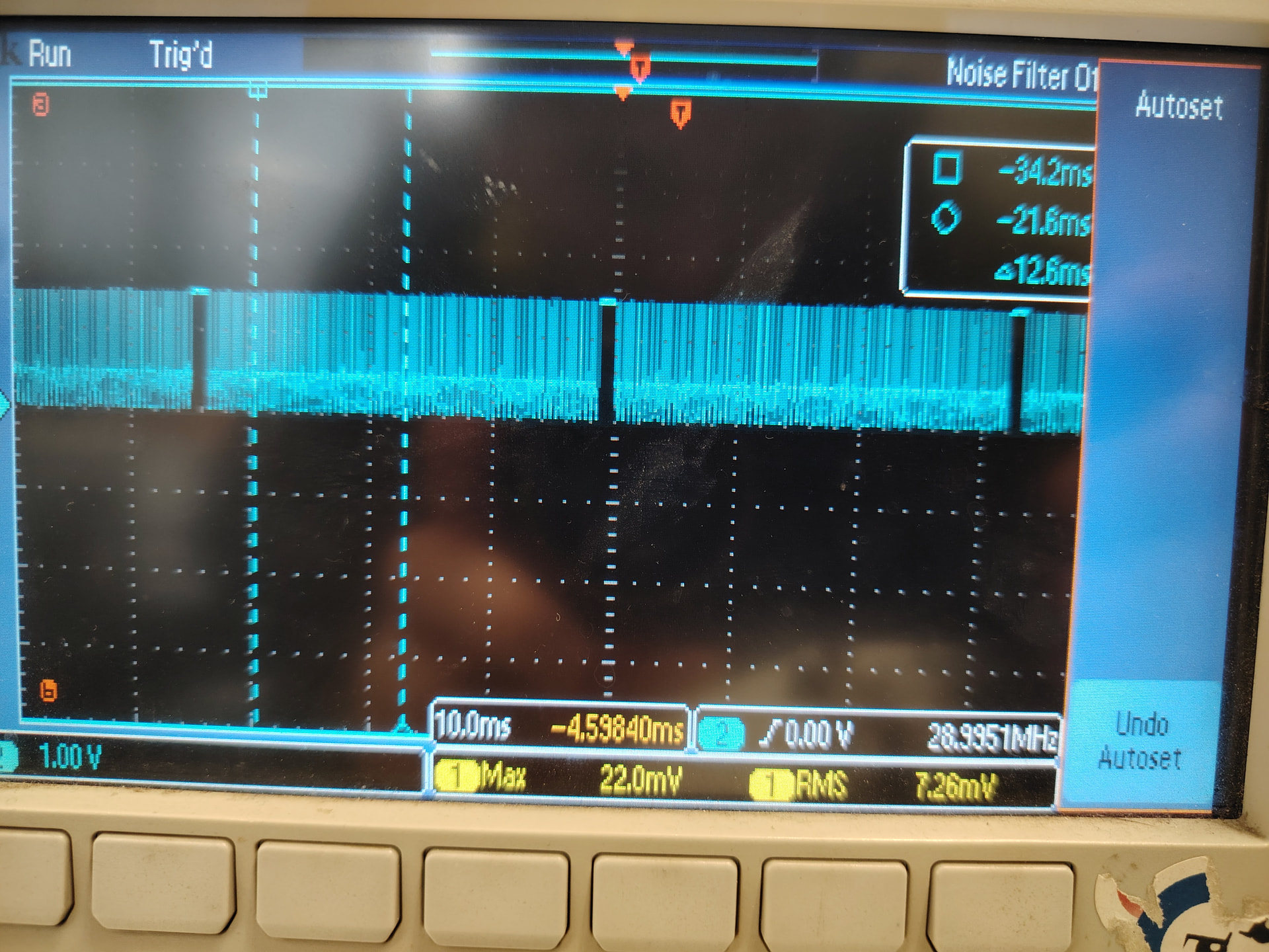

我现在遇到的问题是抓图报错

[ 87.269771] tegra-camrtc-capture-vi tegra-capture-vi: uncorr_err: request timed out after 2500 ms
[ 87.269793] tegra-camrtc-capture-vi tegra-capture-vi: err_rec: attempting to reset the capture channel
[ 87.270834] tegra-camrtc-capture-vi tegra-capture-vi: err_rec: successfully reset the capture channel
[ 89.829748] tegra-camrtc-capture-vi tegra-capture-vi: uncorr_err: request timed out after 2500 ms
[ 89.829769] tegra-camrtc-capture-vi tegra-capture-vi: err_rec: attempting to reset the capture channel
[ 89.830847] tegra-camrtc-capture-vi tegra-capture-vi: err_rec: successfully reset the capture channel
[ 92.357840] tegra-camrtc-capture-vi tegra-capture-vi: uncorr_err: request timed out after 2500 ms
[ 92.357856] tegra-camrtc-capture-vi tegra-capture-vi: err_rec: attempting to reset the capture channel
[ 92.358856] tegra-camrtc-capture-vi tegra-capture-vi: err_rec: successfully reset the capture channel

rgb_clkn
rgb_rx0_dn0
rgb_mclk
上面是示波器抓的rgb RGB_CLKN、RGB_RX0_DN0、CAM0_MCLK
RGB_CLKN示波器图片是这个

as mentioned, please check it’s actually send MIPI signaling (high-speed signal), you may arrange hardware resources to probe the MIPI signaling on the CSI channel for confirmation.
在上面论坛中我给出了rgb_rx0_dn0的示波器图像
看起来mipi是有输入的
