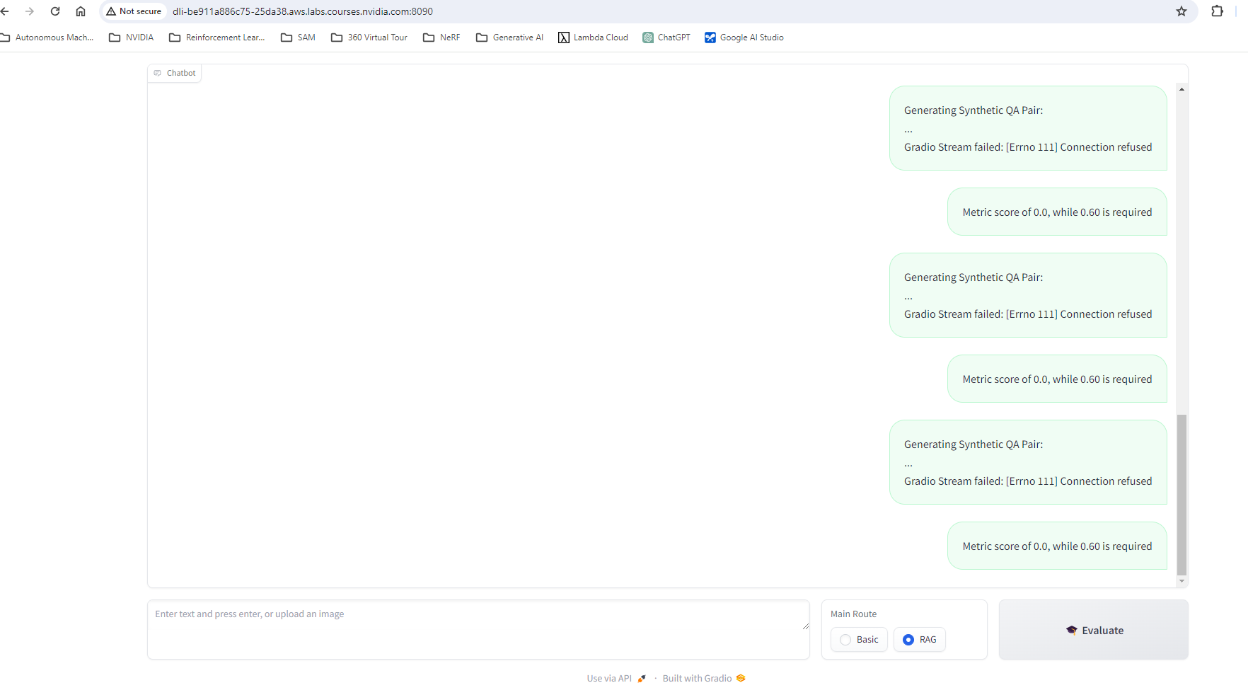

I have gone through all the steps in the course but stuck in Part 5 of 08_evaluation.ipynb, as the final step of this course. I’m not sure what exactly should I do, maybe someone could help on this topic?
First, I’m pretty sure the following conditions are met:
Second, I go back to 01_microservices.ipynb to launch the Gradio interface on port 8090, however, I get error saying Gradio Stream failed: [Errno 111] Connection refused when clicking “Evaluate” button, it looks like the image below
Third, I go back to DLI web site to click “Assess Task” and still get an error saying it does not look like you completed the assessment yet...
Although the course mentioned that we could leverage 35_langserve.ipynb as an example, but I don’t really get how to make it work, should I initiate LangChain Server on the other port rather than 9012?

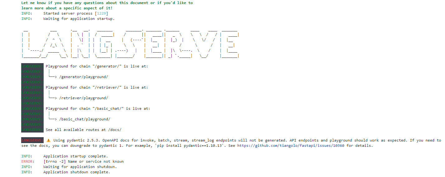

Hi @vkudlay
Thanks for your useful recommendation, after going through LangServe GitHub repo, I managed to add multiple routes on a single application on http://0.0.0.0:9012, and ensure they are working properly by using simple client code to test out, see the following screenshot.
However, by hosting the application on http://0.0.0.0:9012, I’m not able to go through the Evaluate process on Gradio frontend, here is the error
I guess there is something wrong with the hosting address, so I also tried out different addresses, such as
uvicorn.run(app, host="http://dli-be911a886c75-84f58c.aws.labs.courses.nvidia.com", port=9012) and uvicorn.run(app, host="http://lab", port=9012), but I get the following error during the server launch process
[Error -2] Name or service not known
Do you see anything that I could adjust further?

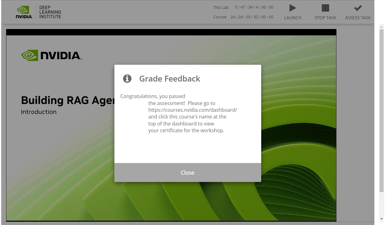

Ha, I see, thanks for your patience with me.
Now I can use the Frontend to pass the assessment as the image below,
and I also pass the assessment on DLI website, thanks for your swift feedback and wish you a wonderful day.
Fantastic!! Great job, and hope you liked the course 😄
