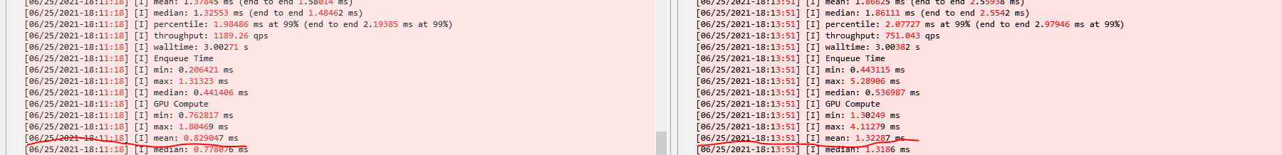

I have attached the output from the following commands:
trtexec --loadEngine=resnet34_peoplenet_pruned_int8.etlt_b1_gpu0_int8.engine --int8 --calib=resnet34_peoplenet_pruned_int8_gpu.txt
trtexec --loadEngine=resnet34_peoplenet_pruned.etlt_b1_gpu0_fp16.engine --fp16
trtexec-int8.log (54.5 KB)
trtexec-fp16.log (35.7 KB)
From the log, INT8 infer time (mean: 0.829047 ms) is much shorter than fp16 infer time (mean: 1.32287 ms), at least, with int8, the infer time is improved much higher than 10%.
So, I think, why you only got 10% improvement with INT8 is because the infer time is very small part of the whole pipeline, and the time of the other part, e.g. decoding, pre-&post-processing, are not changes, so you get less perf improvement with INT8.
Could you increase the “batch-size”, e.g. batch-size=10 and check the fps of INT8 and FP16?
With batch size = 10 I see a much a bigger difference in the TRT results.
int8 = 4.84358 ms mean
fp16 = 9.39056 ms mean
However, when I run the actual deepstream pipeline with 10 streams, the performance of fp16 and int8 is almost identical - no difference at all. This indicates that you are correct and there is probably some bottleneck in the pipeline, but I’m not sure where it could be. I have disabled everything except the source, the streammux, and the nvinfer element.
