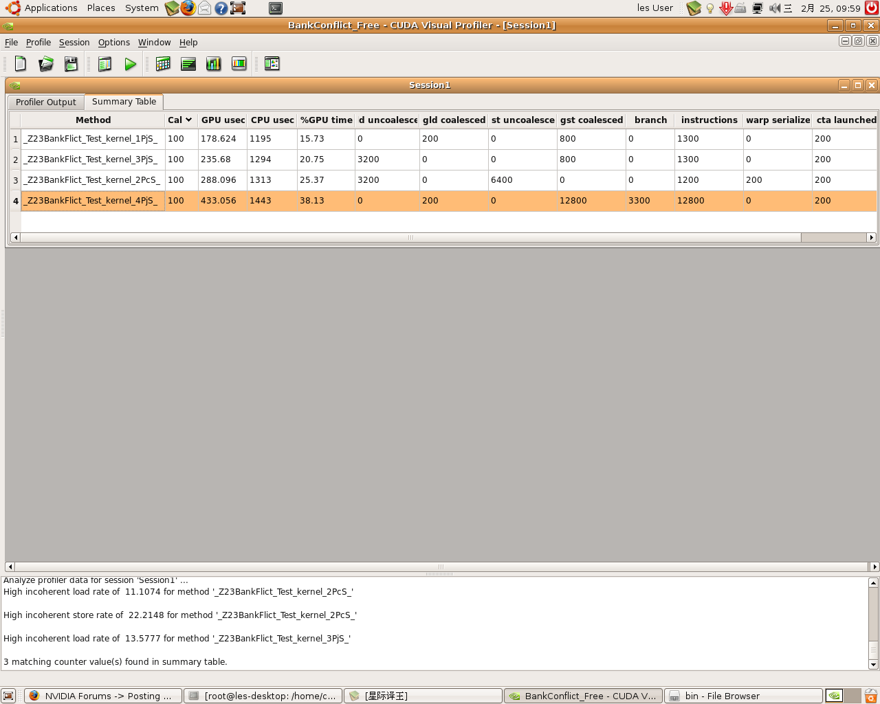

Now I take an experiment about share memory bank conflict.I launched four kernels,each for 100 times,the kernel code is as follows:

The comment line shows what i think the kernel should be.The kernel was launched with <blockNUM,threadsForEachBlock>is<16,16>
But the result is very almost the same.
Kernel 1: processing time is: 0.409000
Kernel 2: processing time is: 0.493000
Kernel 3: processing time is: 0.476000
Kernel 4: processing time is: 0.615000
why does this happen?Normally,The kernel 1 should be ~4x faster than kernel 2. Am i right?What about the kernel 4?It’s bank conflict-free?
I also run the kernel on the Visual Profiler, attched is the result.Any guys can make an explanation?THX.
My guess is that the cycles wasted by the bank conflicts are completely hidden by the time it takes to read and write global memory (much, much slower) in this code. Incidentally, this is why it is best to ignore bank conflicts until you have nothing left to optimize. Other factors in your kernel might make bank conflicts irrelevant. :)
Yeah, it’s a reasonable explanation.Considering that the share memory would only take 1~2 clock cycles to access the memory while 400~600 clock cycles in the global memory.
Thanks for your advice, It’s helpful.
