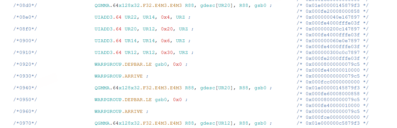

I encountered a strange warning when compiling a GEMM kernel for Hopper cards.
ptxas info    : (C7514) Potential Performance Loss: wgmma.mma_async instructions are serialized due to non wgmma instructions reading accumulator registers of  a wgmma between start and end of the pipeline stage in the function

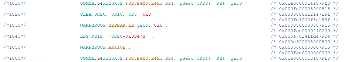

Then I disassembled the executable, seeing PTXAS inserted “WARPGROUP.DEPBAR.LE+WARPGROUP.ARRIVE” between some QGMMA instructions where there are actually NO OTHER INSTRUCTIONS VISITING ACCUMULATOR REGISTERS.
So the question is why PTXAS decides to add synchronization instructions between them (and emit this warning) ? The CUDA toolchain version is 12.8

Now I believe this is a bug of NVCC. Here is a simple program that can reproduce this issue:

When changing the loop times of the “for” loop to an interger constant at line 98 of the code above (and write “#pragma unroll” before that loop), the compiler stops emitting warnings and there are no additional insertions of any synchronization instructions between wgmma instructions.
Generally speaking, the NVCC compiler fails to analyze dependencies of wgmma instructions correctly when encountered simple loop branchings, which is annoying. This issue does not exist for other asynchronous instructions like “cp.async(.wait_group N)”.

Hi, thanks for reporting NVBUG 5431330 . Below the latest engineering team update .
Thank you for reporting this case to us. As you’ve already discovered in your other report, changing the first wgmma.wait_group.sync.aligned 1 in the loop to wgmma.wait_group.sync.aligned 0 can serve as a workaround for the observed behavior.
There is indeed a diagnostic issue in our compiler, it is currently too conservative in detecting register usage within wgmma loops. Specifically, it conservatively assume that certain registers from wgmma are not ready to be accessed in the loop even when they are completed with the mix of “wgmma.wait_group.sync.aligned count 1” and other gmma set.
Switching to wgmma.wait_group.sync.aligned 0 ensures that all wgmma operations are completed, making it the safest way to guarantee the correctness of the results. Until we relax the diagnostic behavior in the compiler, this remains the recommended approach when using wgmma.
We appreciate your feedback and will keep you updated as we address this issue. Thanks again for reaching out.
