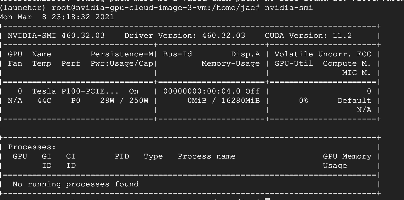

GCP I am using has GPU - NVIDIA Tesla P100
And no, it had driver v450 (see first image), so I went ahead and updated to 460 by downloading the run file from here (Download NVIDIA, GeForce, Quadro, and Tesla Drivers) then following this step to install (NVIDIA Driver Installation Quickstart Guide :: NVIDIA Tesla Documentation). Please see the second image for verification of 460 installation.
Even then, when I run
tlt detectnet_v2 --help
it throws this error -
(launcher) root@nvidia-gpu-cloud-image-3-vm:/home/jae# tlt detectnet_v2 --help

I actually had to do couple of different stuff.
  1. Carefully read through the doc. Saw that P series GPUs are not compatible. So I spun up a new one with V series
  2. It may just be me but I couldn’t install virtualenv on GCP without sudo, so I went ahead and did that
  3. I had to do nvidia docker login as sudo also, which got rid of the issue i was facing (no file found)
For now, this is solved. Thank you for the quick response.
