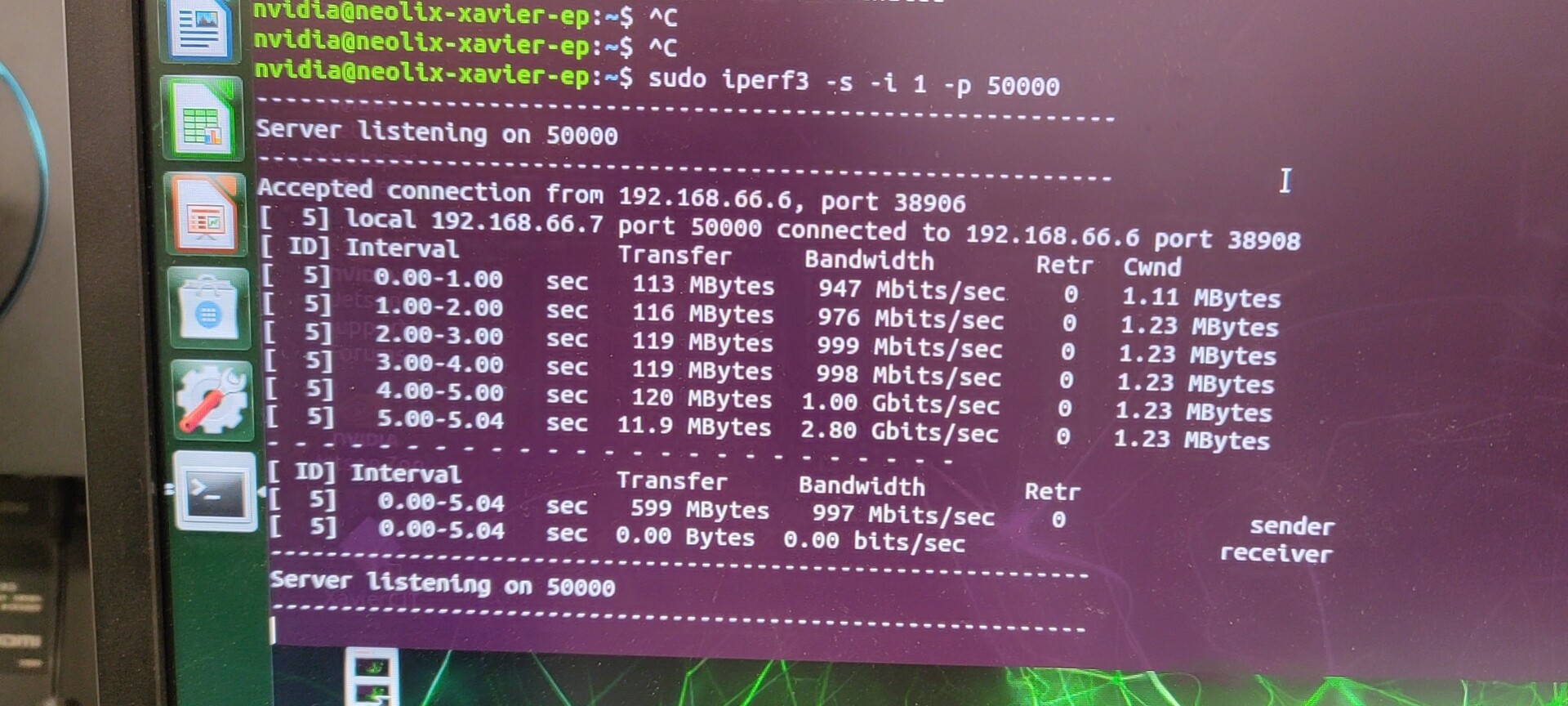

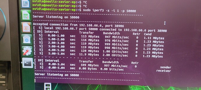

Hi vidyas,
Thanks very much!
we test with iperf:
endpoint : 192.168.66.7
command: sudo iperf3 -s -i 1 -p 50000
root prot : 192.168.66.6
command: iperf3 -c 192.168.10.122 -t 5 -b 1G -P 1 -p 50000 -R
The test results are shown in the figure below:
and:
command: iperf3 -c 192.168.10.122 -t 5 -b 5G -P 1 -p 50000 -R
the result:
May I ask if my above test result is normal?
In addition, we use TCP server and client can transfer large files (such as more than 1G), but with UDP way can not be successfully transferred, will be stuck, how to solve this problem?
Thanks,
BR,
Your TCP perf numbers look fine.
